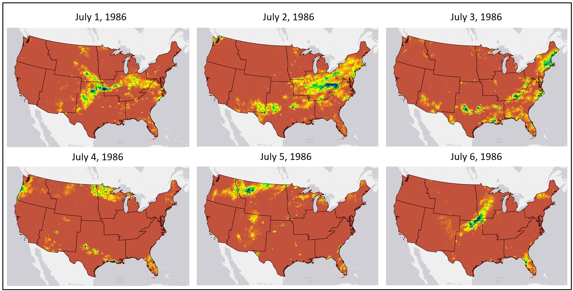

Example maps of daily precipitation rasters for six consecutive days in July 1986.

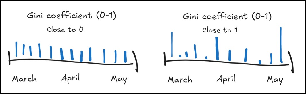

  • Gini Coefficient – quantifies the temporal distribution of precipitation within a season by measuring inequality in the amount of precipitation received during precipitation events
    • Close to 0 = less inequality in precipitation across a season, with each precipitation event having similar amounts (more equality), much like a uniform distribution
    • Close to 1 = more inequality in precipitation across a season, where there is large variation in the amount of precipitation received from event to event
A Gini coefficient of close to 0 (left) indicates that most precipitation events in a season are nearly equal in amount. A Gini coefficient of close to 1 (right) indicates large variability in amount of precipitation from event to event.

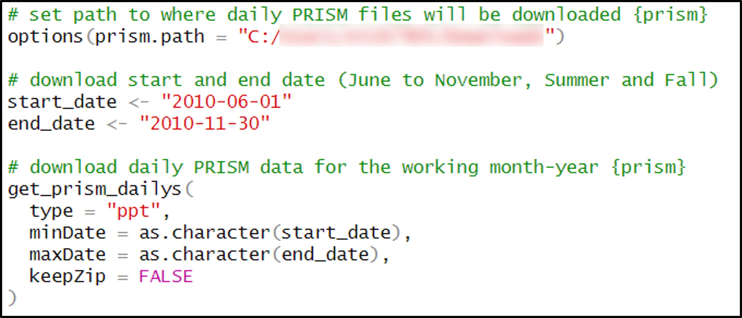

Fortunately, the {prism} package can be used to programmatically access PRISM data.  Within this package, there are a series of functions that allow you to choose which variable and temporal scale you want to download.  In my case, I was interested in daily precipitation data, so I used the get_prism_dailys function.
The "type" argument above allows you to choose from four precipitation variables: precipitation (ppt), mean temperature (tmean), minimum temperature (tmin), maximum temperature (tmax).
Within this function, you can specify the start and end date of the download period.  I knew that downloading and processing ~11,000 rasters at once would not be manageable on my machine (or within R, period), so I would have to download the data and process it in batches.  After a bit of testing and experimentation, it appeared that roughly 200 or less rasters in each batch would be a workable size.  This combined with the fact that each of the precipitation variables is calculated for every season in the 30-year time series, led me to the following pattern for determining the start and end date of each batch:

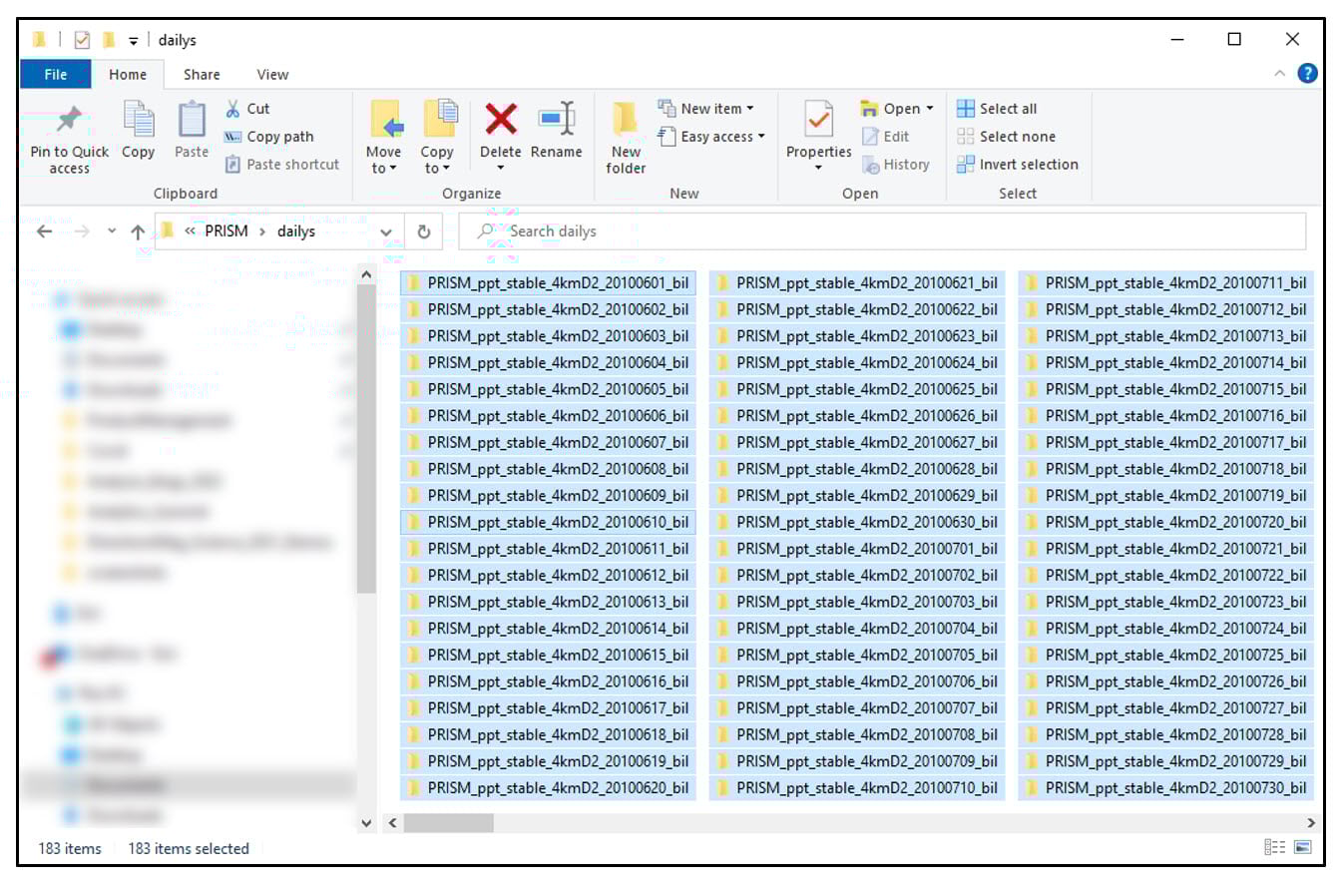

Example of the downloaded daily rasters for one batch from summer and fall of 2010.

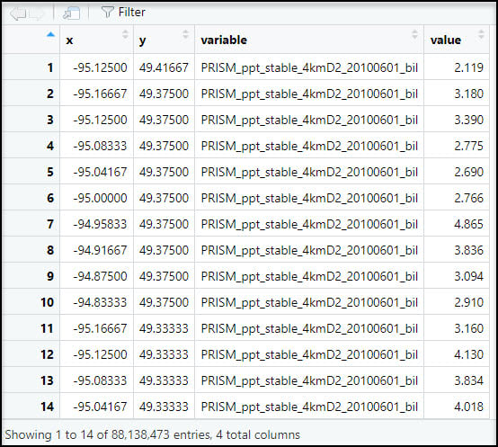

Next, we’ll use the melt function to flip the table from wide (481,631 rows x 185 columns) to long (88.1 million rows x 4 columns), so now the rows contain the entire time series of precipitation at each location.  Note that the “variable” column contains the file name of each input raster.

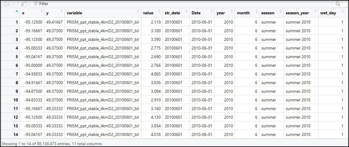

Eventually, we’ll be calculating the seasonal averages of several precipitation variables, so we need a way to assign seasons to each data point.  To do this, we’ll use the substr function to extract the date information based on index positions in the “variable” column and insert it into a new column “str_date”.

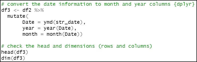

We then use the mutate function four separate times to engineer a series of new variables based on existing variables in the dataset.
  1. Convert the date information to month and year columns.

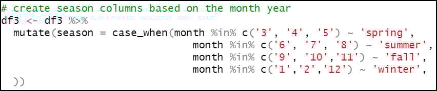

  1. Create a new “season” column, which assigns the months of the year to seasons, following the pattern below:
    • Spring – March, April, May (3rd, 4th, 5th months of the year)
    • Summer – June, July, August (6th, 7th, 8th months of the year)
    • Fall – September, October, November (9th, 10th, 11th months of the year)
    • Winter – December, January, February (12th, 1st, 2nd months of the year)
  1. Concatenate the “season” and “year” columns, so that we can calculate our seasonal averages for each year.
  2. Create a new boolean column “wet_day”, which indicates whether each location experienced precipitation on a particular day. In this case, a location is considered a “wet day” and assigned a value of 1 if it received greater than or equal to 0.1 mm of precipitation in a day, and 0 if less. This indicator column will be used in subsequent steps to calculate the precipitation variables that measure variability across a season.

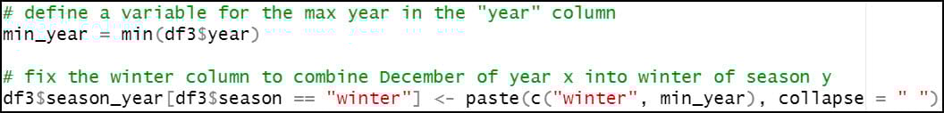

As noted in the section above, the winter season ranges from December 1 of year y to February 28 of year y+1.  As such, we need to ensure that for every time this script runs, any data point in January or February is reassigned to the previous year.  For example, January and February 1982 actually belong to the winter season of 1981.  So here, if the “season” column contains “winter”, we update it with the previous year.  Otherwise, the “season” column remains the same.
Data frame showing the results of the previous four steps. Note the new date columns, as well as those for "season", "season_year", and "wet_day".

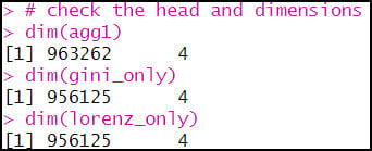

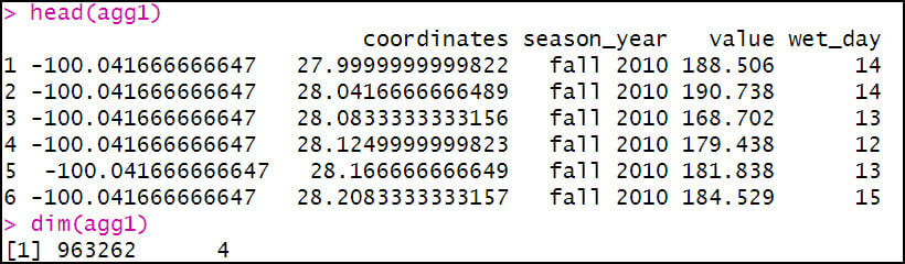

The first aggregation calculates the total precipitation (“value”) and total precipitation days (“wet_day”) within a season (“season_year”) for each location (“coordinates”) in the dataset.  The FUN argument specifies the summary statistic that is applied to each subset (location/season pair), which in this case is sum to get the total precipitation (mm) and total days with precipitation in a season.

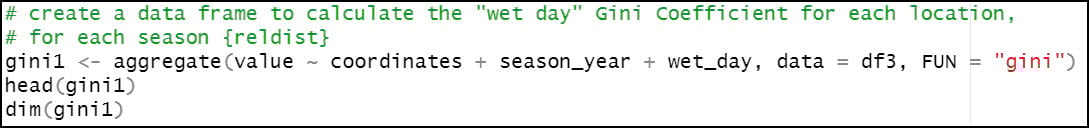

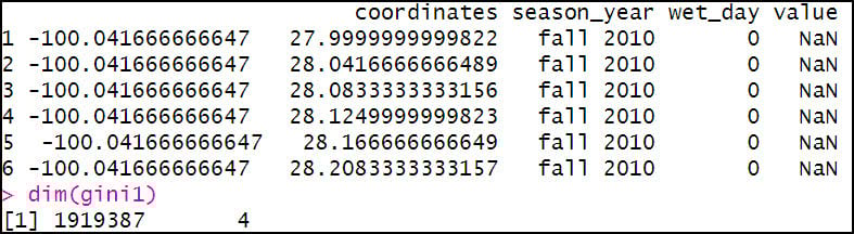

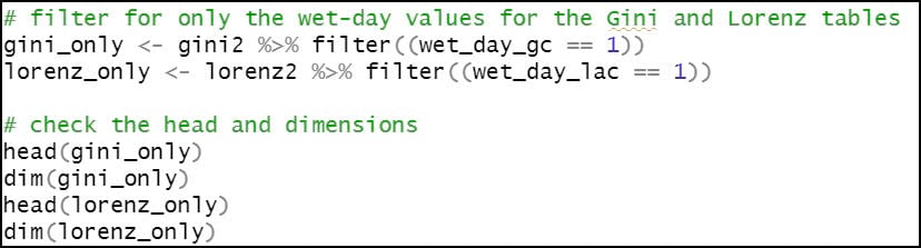

The second aggregation calculates the Gini Coefficient of precipitation within a season for each location.  Note here that “wet_day” is included in the aggregation because the Gini Coefficient calculation only includes days when precipitation occurred.  The FUN argument here calls the gini function from the {reldist} R package.

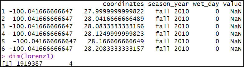

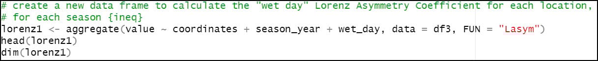

The third aggregation calculates the Lorenz Asymmetry Coefficient of precipitation within a season for each location.  Like the Gini, “wet_day” is included in the aggregation because the Lorenz Asymmetry Coefficient calculation also only includes days when precipitation occurred.  The FUN argument here calls the Lasym function from the {ineq} R package.

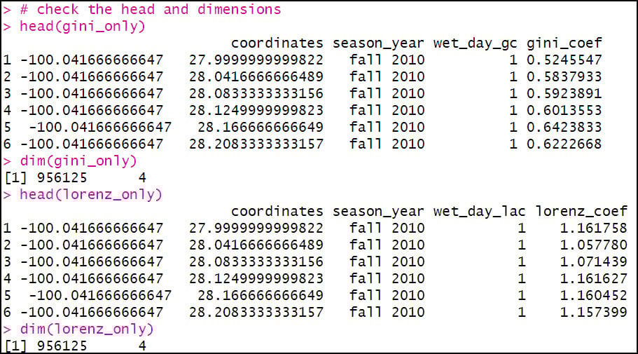

After a few more lines of code to rename columns to make them more understandable, we now have three separate data frames containing our calculated precipitation variables.  Because we know that the Gini and Lorenz Asymmetry Coefficients can only be calculated on days when precipitation occurred, we use the filter function to return rows that meet a condition, in this case “wet_day” = 1.

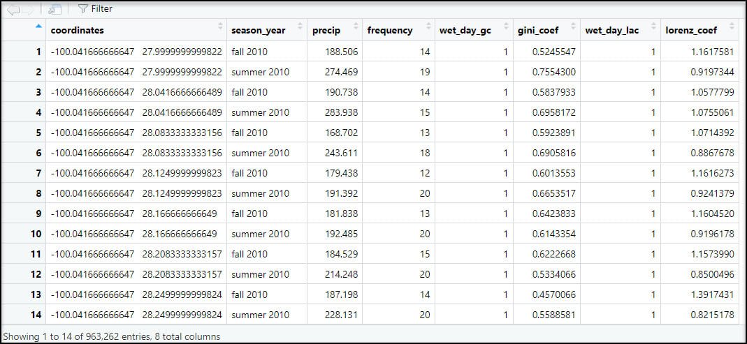

We’ll then join these three separate data frames together using the merge function two times in a row.  First, we join the Gini and Lorenz data frames together, then we join that result to the data frame containing the aggregated total precipitation and precipitation days attributes.  Note that in both of these joins, the common attribute (key field) is actually a combination of the “coordinates” and “season_year” columns, because there are precipitation variables for two seasons for each location.
Data frame showing the four precipitation variables calculated for two seasons (Summer and Fall of 2010).
