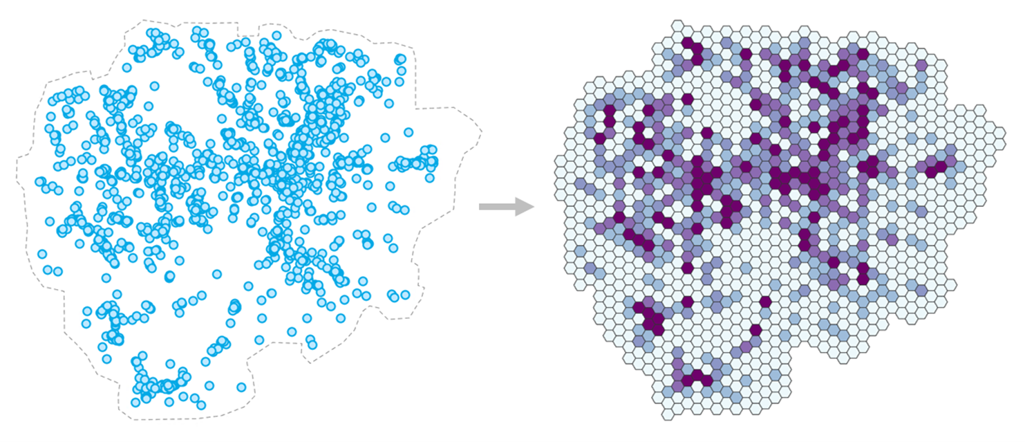

One of the most common workflows in GIS is aggregating point data into bins – whether you’re mapping emergency calls, building permits, disease cases, wildlife sightings, or another spatial phenomenon. But at the center of these workflows there is a critical question: What bin size should I use?
With ArcGIS Pro 3.6, we’re excited to introduce a new geoprocessing tool that can help you answer that question: Evaluate Bin Sizes for Point Aggregation.

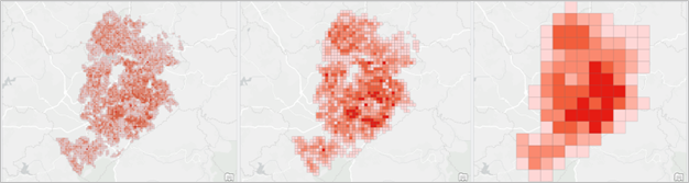

Choosing a bin size isn’t just a visualization decision – it has major impacts on downstream analysis. The size of your bins affects what patterns you detect and how you interpret them. Bins that are too small may be sparse and noisy, while bins that are too large can obscure important local variation. This is a classic example of the “scale effect” associated with the Modifiable Areal Unit Problem (MAUP), and it’s why justified, reproducible bin size selection is so important.
Three side-by-side point aggregations with small, medium and large bin sizes, illustrating the varying patterns revealed by different bin sizes.
Bin size shapes the patterns revealed in your map – and the results of analysis.
In some cases, bin size choice is guided by use case, analytical workflow, or theoretical framework. But more often than not, we find ourselves making arbitrary decisions, relying on intuition or what “looks right” on the map. The new tool replaces this guesswork with data-driven guidance.

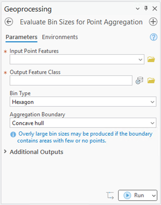

The Evaluate Bin Sizes for Point Aggregation tool is simple to use. Just provide a point dataset and set an aggregation boundary to define the area where points can occur.
Geoprocessing tool dialog showing the Evaluate Bin Sizes for Point Aggregation tool showing the parameters for the tool.
The Aggregation Boundary can significantly influence results, especially if it includes large areas with few or no points. This may lead to a larger-than-expected recommended bin size. You can supply a custom polygon, draw one interactively, or choose a minimum bounding geometry option. We recommend specifying a custom boundary when possible, though the default option of Concave Hull can often provide comparable results.

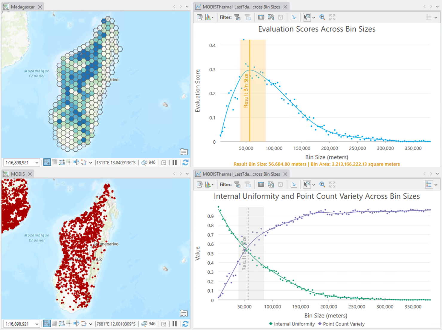

  • Charts showing the evaluation score and its components, Internal Uniformity and Point Count Variety, across the tested bin sizes
Screenshot of tool results for an aggregation of points in Madagascar, including the point aggregation layer and two charts.
This example aggregates thermal activity detected by MODIS over the past 7 days in Madagascar to hexagonal bins. The selected bin size (height) is about 57 kilometers.
Review the outputs to decide whether to use the suggested bin size or select another – for example, perhaps you want to use an H3 hexagon resolution that falls within the confidence interval. If needed, use tools like Generate Tessellation and Summarize Within to create your own aggregation.

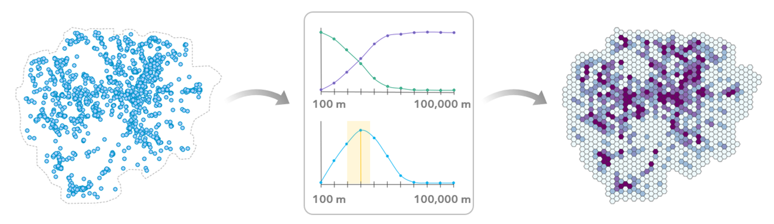

Behind the scenes, the tool evaluates a range of bin sizes by calculating an Evaluation Score for each. This score balances two competing criteria: Point Count Variety (favoring larger bins) and Pattern Preservation (favoring smaller bins).
Diagram showing scattered blue points with an arrow to the two charts associated with the tool with another arrow to the aggregated points, illustrating the process of data-driven point aggregation to a recommended bin size.
The bin size with the highest Evaluation Score is selected as the output bin size. The tool also provides a confidence interval, highlighting other bin sizes with scores that aren’t significantly lower, giving you flexibility in your final choice.
