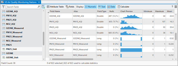

Data Engineering is a view in ArcGIS Pro that allows you to explore, visualize, clean and prepare your data. The data engineering process is a common first step for many spatial analysis and mapping workflows. The Data Engineering view and ribbon can help you better understand your data and prepare it for GIS workflows.
Data Engineering view in ArcGIS Pro
How can data engineering facilitate my work?
You don’t have to be a data scientist to use data engineering in ArcGIS Pro. In fact, here are some very common questions that can immediately be answered by popping open the data engineering view:
  1. How many fields are there in this dataset?
Open the Data Engineering view and find the Field Count in the lower left.
  1. Does this field contain null values?
Calculate statistics for a field or fields. You’ll immediately see the number (and percent) of null values for the field(s). Right-click to select nulls making it easy to continue work in the map and attribute table to populate the values as needed or launch the Fill Missing Values tool.
  1. What is the sum of values for these selected features?
Another quick statistics calculation will get you that sum.
  1. What is the average value for all records (or a selection of records)?
You guessed it! The Data Engineering view contains not only the mean, but also median, mode, least common value and a number of other statistics.
Some of my personal favorite functionality is the ability to filter and search fields to surface just what you’re looking for.
Use filter and search in the Data Engineering view to quickly find fields
