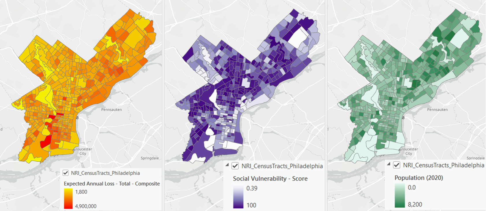

After preparing a subset of census tracts for Philadelphia, we first visualize several NRI variables—including expected annual loss, population, and social vulnerability—to understand how risk and burden are distributed spatially.
Visualizations of three NRI Variables (left to right: Expected annual loss, Social vulnerability, and Population)
This exploratory step helps frame the analytical goal of our analysis:
We want 10 zones that carry comparable total expected annual loss and population, while keeping average social vulnerability levels as consistent as possible across zones.

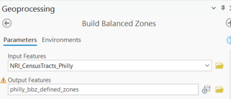

To achieve this, we first input the census tracts in Philadelphia, and specify the output name.

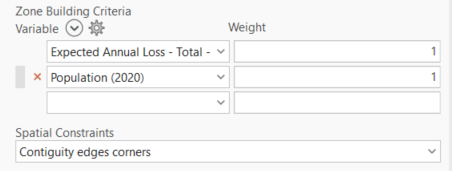

Then we configure the Build Balanced Zones tool using the Number of zones and attribute target method, specifying the Target Number of Zones as 10.
Next, we set expected annual loss and population as Zone Building Criteria, ensuring that each zone meets these balancing requirements during generation.  If you give different weights to your Zone Building Criteria variables, the variables with higher weights will be prioritized during the zone selection process. In this workflow, we’ll just keep the default.

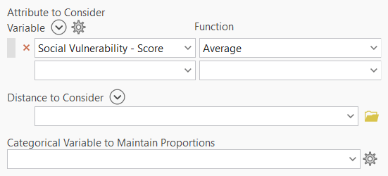

Additional preferences such as compactness and consistency in average social vulnerability are applied during the zone selection stage. Through these settings, the tool will prefer compact zones that have a similar average social vulnerability score.

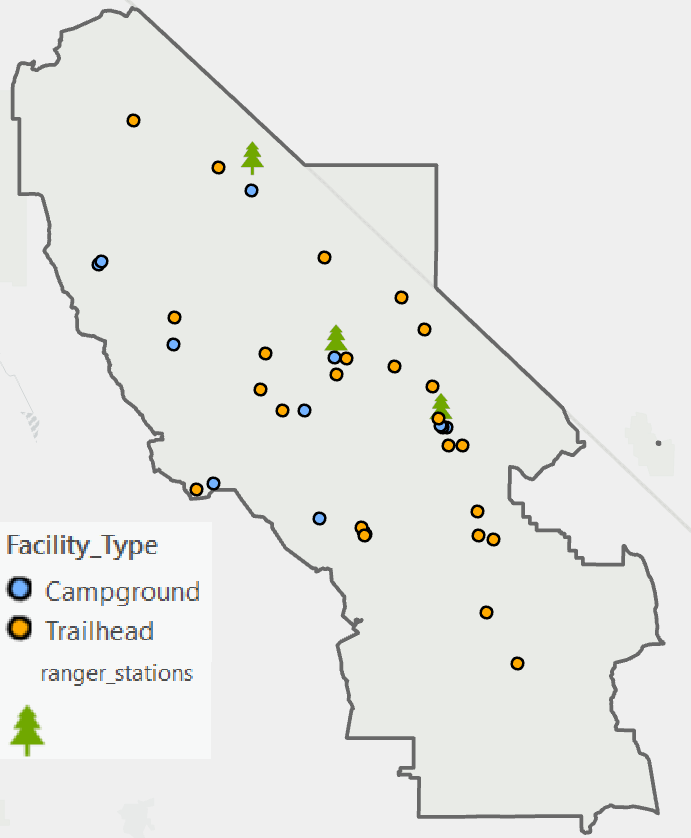

In this workflow, we are going to help a national park create a maintenance plan to maintain all the trailheads and campground areas in the park. The goal is to divide the task locations into several service zones and allocate the workload equally. We need to develop zones around the existing ranger stations to make sure the plan is cost-efficient and manageable.
Locations of campgrounds, trailheads and ranger stations in the nation park

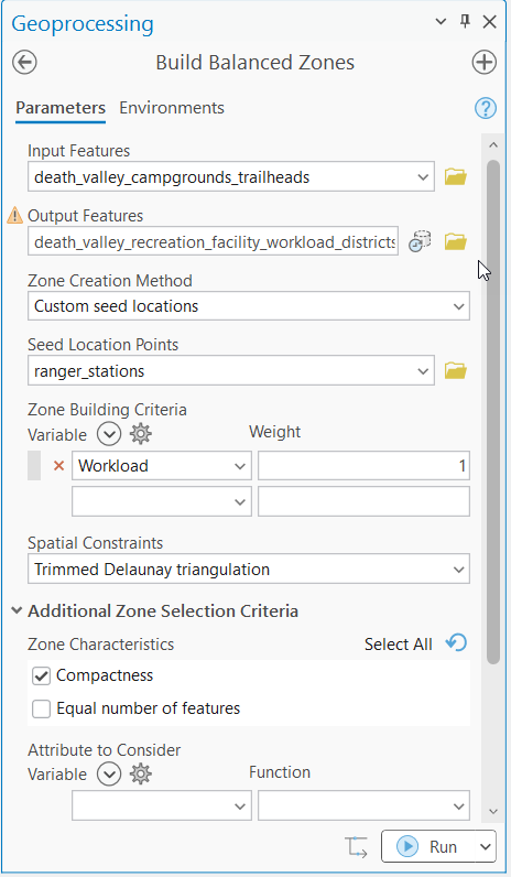

Within the Build Balanced Zones tool, we input the task locations as input features and select Custom seed locations as the Zone Creation Method. Next, we provide the ranger stations as Seed Location Points. This ensures that each zone grows outward from an existing ranger station, generating zones that are easy to manage.

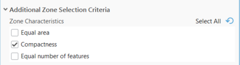

Each task location carries a workload value based on estimated maintenance effort. And the workload values are supplied as the Zone Building criterion, while compactness is used as a zone characteristic to keep zones spatially efficient.
Parameter Settings For Workflow 2

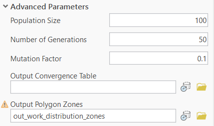

To support visualization, communication, and downstream analysis, it is often useful to convert these point‑based zones into explicit spatial boundaries. Build Balanced Zones can now optionally generate an Output Polygon Zones layer, representing the spatial extent of each zone. We will choose this option under the Advanced Parameters.

Distance to Consider parameter can be used to favor zones that are closer to specific facilities or points of interest, such as hospitals, service centers, or depots. This is useful when proximity or response time is an important consideration.
Categorical variables can be included to maintain proportions of categorical attributes—such as land‑use type—across or within zones. This helps preserve important categorical patterns while still balancing numeric criteria.
Advanced parameters expose additional controls over the genetic algorithm, including population size and mutation behavior. While the default settings work well for most workflows, these options can be useful when fine‑tuning performance or experimenting with alternative solutions.
