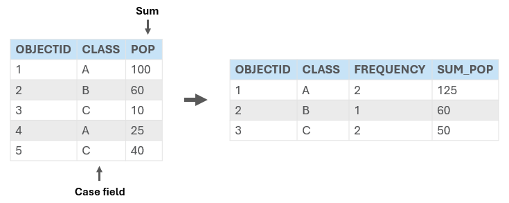

One of the most commonly used tools in ArcGIS Pro is Summary Statistics. It calculates the statistics (sum, mean, etc.) of attribute fields from an input dataset, and creates an output table with the summarized values. And you can group those statistics based on unique values from a specified Case Field.

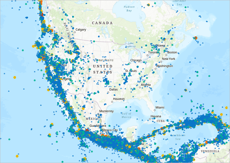

To compare the performance between the DBMS and the client-side statistics, let’s find the maximum recorded earthquake magnitude since 1900.
The Earthquakes Archive from the ArcGIS Living Atlas contains all earthquakes with a magnitude over 4.0 from 1900 to the present day. This dataset is updated once a day and has nearly half a million records (accessed Nov. 11, 2024).
Earthquake Archive
Earthquake Archive from the Living Atlas

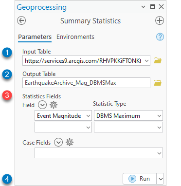

On the Geoprocessing pane, open the Summary Statistics tool and set the following parameters:
The Summary Statistics tool with steps
  1. Input Table: https://services9.arcgis.com/RHVPKKiFTONKtxq3/arcgis/rest/services/Historical_Quakes/FeatureServer/0
  2. Output Table: specify a name and location
  3. Statistics Field: Event Magnitude; DBMS Maximum
    Note: DBMS and client-side statistics cannot be processed at the same time. Run the tool multiple times if you need both traditional and DMBS statistics calculated. You can join your results together using Join Field.
  4. Run the tool.
  5. Change the Statistic Type to MAX and the output table name. Then Run the tool again.
Notice that the DBMS_MAX is over 70 times faster than the client-side Max!

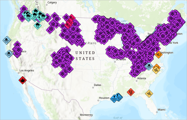

The ArcGIS Living Atlas has a NOAA weather report dataset with continuously updated storm reports for the past week. The dataset is updated every 15 minutes and is filtered to display data from the past 24 hours.
NOAA Weather Reports
NOAA Weather Report Map from the Living Atlas
Let’s summarize the weather data to find out where snow has been reported and get the average magnitude of the snow events. And since this dataset is updated every 15 minutes, let’s also schedule the tool to get new results over time.

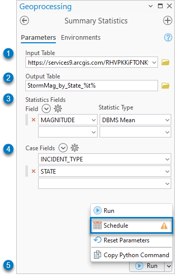

In the Summary Statistics tool, set the following parameters:
  1. Input Table: https://services9.arcgis.com/RHVPKKiFTONKtxq3/arcgis/rest/services/NOAA_storm_reports_v1/FeatureServer/4
    Note: Its recommended to use the full data path instead of the layer as an input for scheduled processes to ensure the tool runs regardless of the project availability. But this means the filter will not be used in the input; so instead, the tool will calculate statistics for the entire week.
  2. Output Table: Storm_Report_by_State_%t%
    Note: The time stamp variable, %t%, is added to the output name to create a new output each time the tool runs with the tool run time in the output name.
  3. Statistic Fields: MAGNITUDE; DBMS Mean
  4. Case Field: STATE; INCIDENT_TYPE
  5. Open the Run button split menu and select the Schedule button schedule_icon to open the Schedule dialog box.
    Note: You may see a warning warning_icon next to the schedule button reminding you to save the project. If you had used a layer as an input to the tool, saving the project would be essential because the schedule is referencing the layer through the project file (.aprx). But by using the full data path as an input, we ensured that the schedule could access the dataset directly without relying on its layer connection in the project.

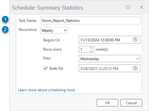

On the Schedule dialog box, set the following properties:
Schedule dialog box
Schedule dialog box
  1. Task Name: Storm_Report_Statistics
  2.  Recurrence: Weekly
This results in a new output table each week with the average magnitude of the weather events that have occurred in each state.

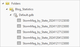

The scheduled tool’s output is available in the specified save location.
Output location
Scheduled tasks output location
Open the output attribute table to view the average magnitude of the weather events each week.
