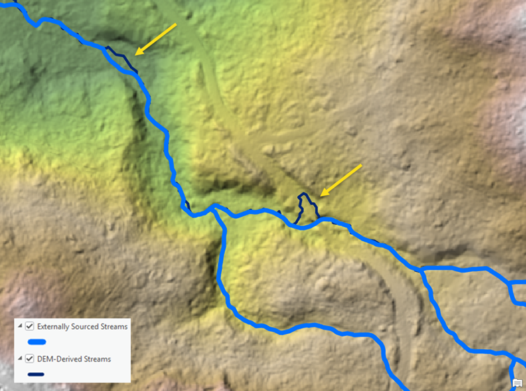

Two different sources of stream data.
Deriving streams directly from elevation data can be different from external sources of stream data at specific locations. See locations pointed by the arrows.
