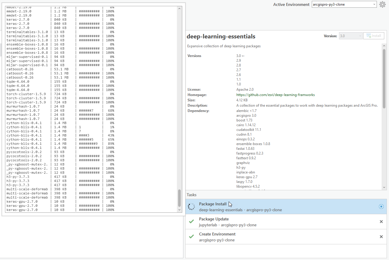

Tasks Queue
The UI now provides more and better feedback. You can find a new tasks queue at the bottom right of the Package Manager. When you clone, install a package, or refresh, a conda operation is executed. All Conda operations (eg: clone, install package, and refresh) are now added to the tasks queue and will run in the background, leaving you free to continue working.
Hovering over a task will display a floating window containing all messages from the current task, so that you can monitor what conda is doing. While the task is being performed, messages will appear in the window in real time. Completed tasks will remain in the tasks queue until you close ArcGIS Pro, allowing you to see a history of the current session’s tasks.

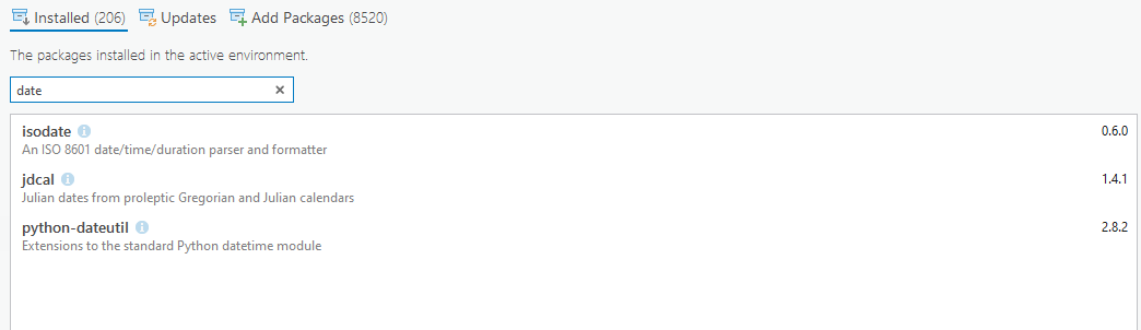

Search
Previously, the search box to find new packages was only available on the Add Packages tab. With ArcGIS Pro 3.0, you can also search the Installed and Updates tabs. In addition, packages can now be searched by name or by a keyword, making it easier to locate the package you are looking for.
Search packages
Search for installed packages that have "date" in their name or description.

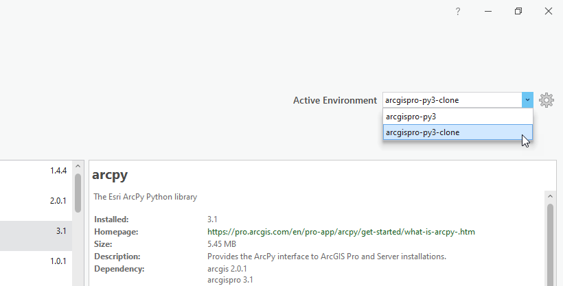

Environment Activation
The name of the active environment is now displayed at the top right of the Package Manager next to the Environment Manager button Manage. In addition to clicking the Environment Manager button to activate an environment from the Environment Manager dialog box, you can now also use the pull-down to quickly activate an environment.
Activating an environment
Activate an environment by using the active environment drop-down menu. Note that the drop-down menu will only contain one environment if you do not have additional environments available.

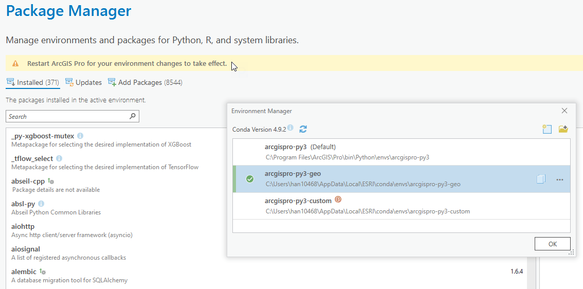

Initialized Environments

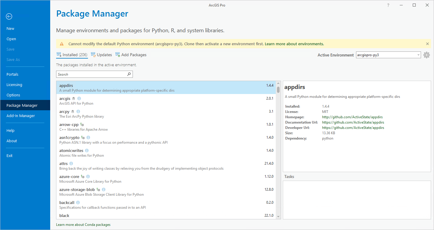

At certain times you may notice a yellow warning banner across the top of the Package Manager. This is part of our effort to better communicate the state of an environment. There are two banners you may see: a warning that the default arcgispro-py3 environment is active (and therefore packages cannot be modified), or a warning that a restart is required. The warnings are not new, but they are now featured more prominently.
At ArcGIS Pro 3.0 a Python Interpreter icon Python Interpreter may appear next to an environment name in the Package Manager dialog box. This icon complements the “restart required” warning and is intended to make this requirement more transparent.
In short, the Python Interpreter icon is displayed next to an environment’s name if the interpreter has been initialized for it. What does that mean? It means that the interpreter is now running from that environment. Because Python is integrated into the framework of ArcGIS Pro, the Python interpreter is locked to this environment until ArcGIS Pro is closed, thus requiring a restart to use a different environment.
The interpreter is initialized whenever it is first needed for notebooks, the Python window, certain geoprocessing tools, or other areas of the software. Other environments can still be activated and modified even after the interpreter has been initialized on an environment, but ArcGIS Pro will continue to use the initialized interpreter until the application is restarted.
You can easily identify an initialized environment by checking for the Python Interpreter icon. When an environment other than the initialized environment is activated, the yellow warning banner will remind you to restart ArcGIS Pro to use that environment.
Interpreter is initialized
The interpreter is initialized on the arcgispro-py3-custom environment, but currently arcgispro-py3-geo is the active environment. The warning banner indicates that to use the interpreter of arcgispro-py3-geo, ArcGIS Pro must first be restarted.
To summarize, you can think of environments in ArcGIS Pro as having inactive, active, or initialized states. Inactive and active states are mutually exclusive—an environment is either active or inactive. However, after the interpreter is initialized on an active environment, the interpreter will remain initialized on the environment for the remainder of the session, independent of whether it is currently active or inactive.

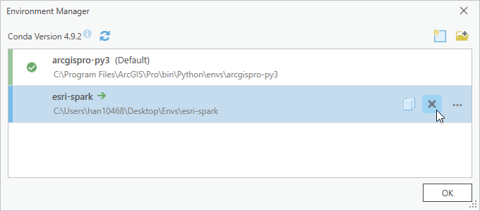

Remove External Environments
External environments that you have added to ArcGIS Pro can now be removed from the environments list on the Environment Manager (as opposed to deleted outright). External environments are defined as any environment that is not located in the default cloned environment directory for ArcGIS Pro, %localappdata%\ESRI\conda\envs. If the environment is outside of this directory, it will have an External icon External environment next to the name and can be removed from the Environment Manager list using the Remove button Remove.
