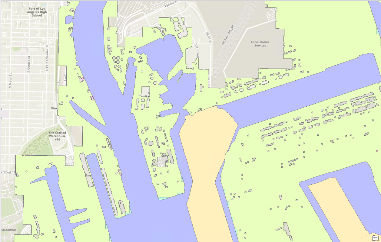

The tool allows you to export footprints from the BisCatalog to a new feature class. These footprint polygons can be useful in supplementing nautical charts, hydrographic models, and spatial analysis workflows including . When exporting, you can optionally deconflict the footprints.
Deconflicted footprints exported with a Survey Date rule file applied.
When footprints are deconflicted, they are exported as nonoverlapping polygon features in which footprints with the highest draw order are preserved and ones drawn below that are modified to exclude overlapping areas. This tool also accepts filters created with the Explore Bathymetry tool and rules and models created with the Compose Surface tool to define the subset and order of data that is exported when the tool is run.
