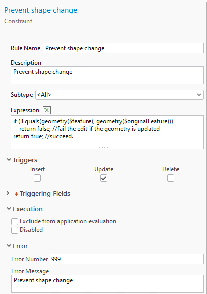

Suppose you have a constraint attribute rule that prevents certain users from moving a feature once it is created. You might author the rule in this manner.
It is a simple rule and it works. If you try to move an existing feature the edit fails, try to update any other attribute and the edit succeeds. This is because when you update a feature, we always fire the attribute rule and provide the $feature as the current edited feature and $originalFeature as the state of the feature before the update. Arcade then takes over, parses the script, executes the code to compare the two geometries and then returns true or false.

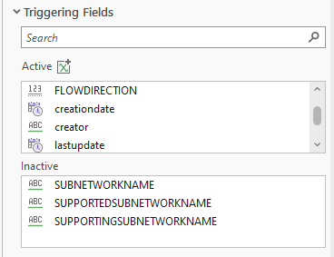

When creating an immediate attribute rule that includes a triggering event for update, you are presented with a list of fields. The triggering field list allows you to further refine the update event to only trigger when the value in specific field(s) change. By default, all fields are selected, meaning that any update to the feature will trigger the attribute rule. This was done for backward compatibility to older ArcGIS Pro clients. You should consider this list and remove any fields that you don’t want to trigger the rules.
You can also use the Add from script button which will analyze the Arcade script and adds all the fields used by $feature in the script. You can of course make additional changes as you see fit.
Once you set the list of triggering fields, save the rule. The rule will now only run if any fields from the list of triggering fields are updated. Let’s re-examine our previous example and update the rule to only trigger on a shape field edit using the triggering fields functionality

With triggering fields in 3.4, users can exclude the subnetwork name, isconnected, and any propagated fields from the triggering fields. These fields are all modified by the update subnetwork process, so excluding them from your triggering field list will ensure your attribute rules won’t fire during update subnetwork. This allows customers with attribute rules who use eventing to greatly improve the performance of update subnetwork.
