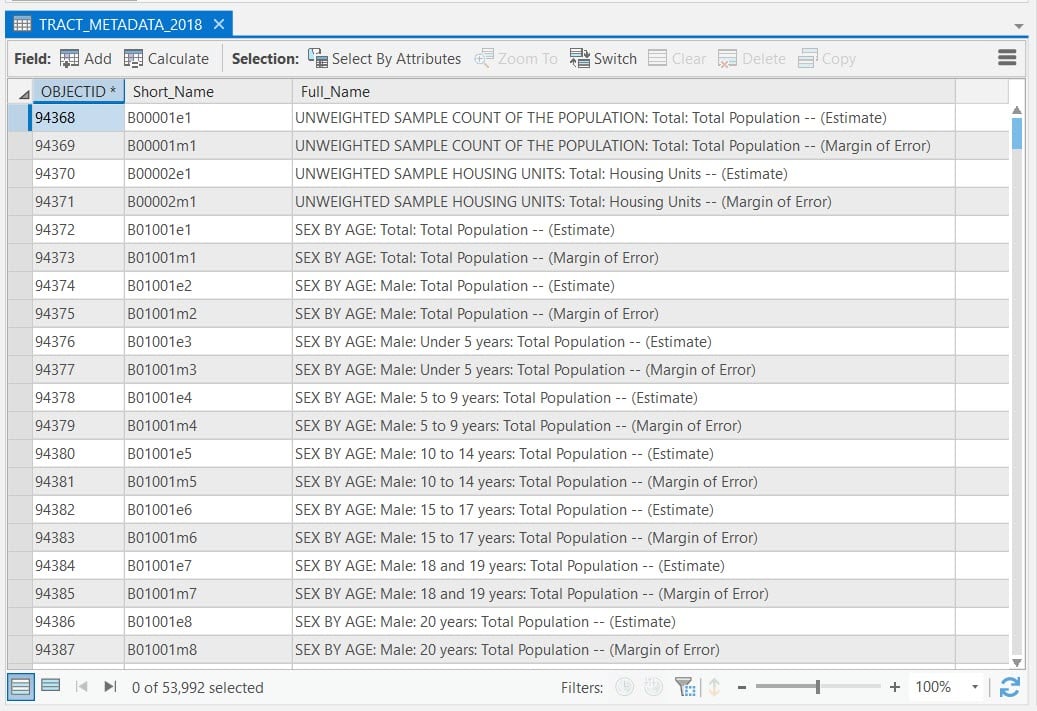

Here’s the metadata table:
A two-column table. First column is called Short_Name and contains the cryptic field names such as B01001e1. Second column is Full_Name and contains a descriptive field alias.

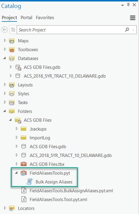

Step 1. Download either the stand-alone script, or the Python toolbox containing the Bulk Assign Aliases script tool. Save and extract the files in your Pro Project’s folder.
Step 2. Within the Catalog Pane, navigate to the stand-alone script or the tool in your folder connections. (You can also see the stand-alone script by right-clicking the script tool and selecting Edit.)
Within your folder connections, expand the toolbox and see the script tool called Bulk Assign Aliases.

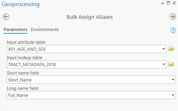

Step 3. If running the script tool, set the parameters you want.
Input attribute table: X01_AGE_AND_SEX. Input lookup table: TRACT_METADATA_2018. Short name field: Short_Name. Long name field: Full_Name.
Step 4. Run the tool or the script, and be patient. It will most likely take some time.

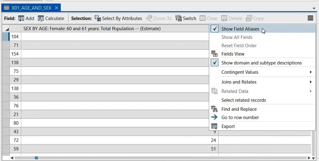

Step 5. Open up your attribute table, and see your fields with aliases:

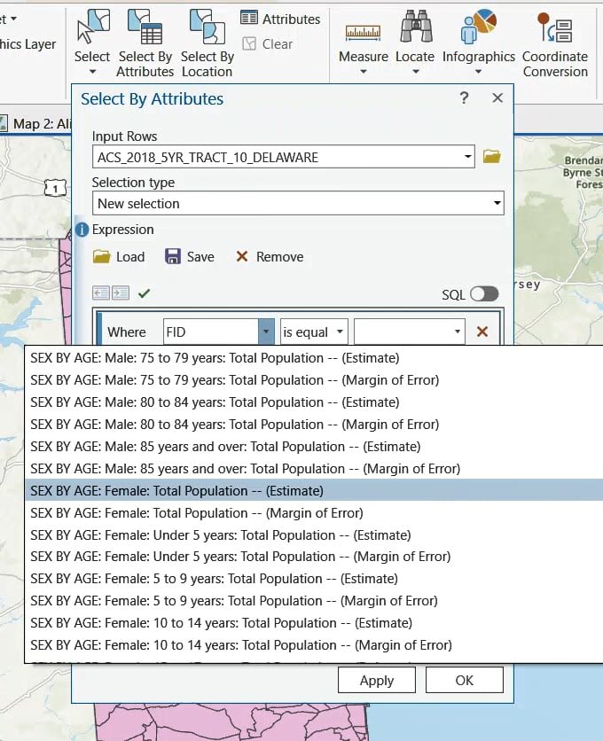

Aliases show up throughout ArcGIS Pro and ArcGIS Online
Aliases show up when working with the data, such as when selecting by attributes.
