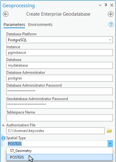

If you only require a PostGIS spatial data type, use the new Spatial Type parameter on the Create Enterprise Geodatabase geoprocessing tool when you create a geodatabase in PostgreSQL. If you specify PostGIS for the Spatial Type, you don’t have to configure the ST_Geometry type.
The Spatial Type parameter is available starting with ArcGIS Pro 2.9 and ArcGIS Enterprise 10.9.1 for use with on-premises PostgreSQL databases.
The Create Enterprise Geodatabase includes a Spatial Type option to create a geodatabase in PostgreSQL that uses only PostGIS.
Choose PostGIS for the Spatial Type.
