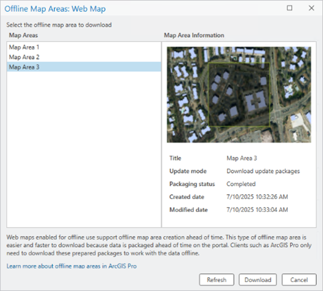

4. In the Offline Map Areas window, select the desired map area.
5. Click Download.
Offline Map Areas dialog box
A progress bar appears while data for the web feature layers is taken offline. When the process is complete, a mobile geodatabase containing the offline data appears in the project’s home folder by default. The geodatabase download location can be specified using the ArcGIS Pro sharing and download options. (If multiple web feature layers are taken offline, there are multiple geodatabases.) The geodatabase is added to the project, and a new map is opened with feature layers that reference feature classes in the mobile geodatabase.
