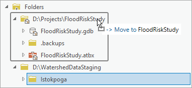

When you drag an item from Folder A and hover over Folder B, a ScreenTip confirms the operation. You’ll see Copy to <Folder B name> or Move to <Folder B name>.
ArcGIS Pro Catalog pane showing an item being dragged from one folder to another
An item is dragged to the project home folder from another folder on the same drive. The ScreenTip identifies the operation (Move) and the target folder.
This ScreenTip behavior is similar to File Explorer. And like File Explorer, the ScreenTip changes as you hover over different folders or press and release keys. For example, if you start to drag an item from Folder A to Folder B on the same drive, the ScreenTip says Move to <Folder B name >. If you then press the Ctrl key, the ScreenTip changes to Copy to <Folder B name>.

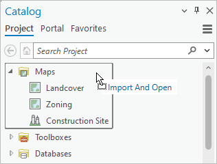

Drag and drop has another important catalog function: you can use it to add or import items to the current project. For example, dragging a file geodatabase from a folder connection to the Databases container Databases container adds it to the project. Similarly, dragging an ArcGIS Pro map file (.mapx) or an ArcMap document (.mxd) from a folder connection to the Maps container Maps container adds it to the project and opens it in a map view.
If the project doesn’t yet contain a map, there isn’t a Maps container. In this case, you can drop the file just about anywhere in the Catalog pane or the Contents pane of a catalog view. The cursor ScreenTip shows Add and Open or Import and Open and the project container is created on the spot. (But if you drop the file on a folder, the file is copied or moved—not added to the project.)
The Catalog pane showing a file being dropped on the Maps container.
An item (an .mxd file in this case) is dragged to the Maps container in the Catalog pane. When it’s dropped, the map is imported and opened.
