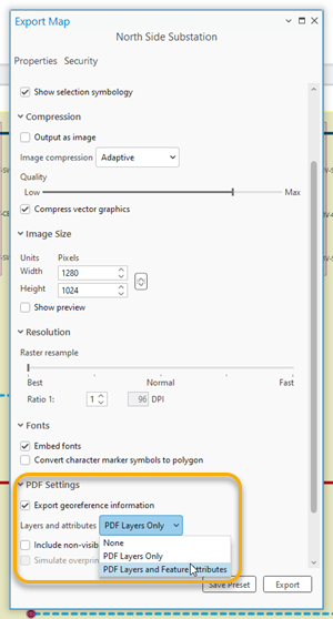

Benefits of exporting in PDF format
In the Export Map or Export Layout dialog box, when exporting in PDF format, you can select PDF Layers and Feature attributes in the PDF Settings section.
PDF Layers and Feature Attributes option in the Export Map dialog
This advanced setting allows you to export diagram sub layers as separate layers and include visible attributes from the diagram feature classes in the output PDF document. You can then view and manage these exported layers and feature attributes in supported PDF readers such as Adobe Acrobat Reader, as shown below:
