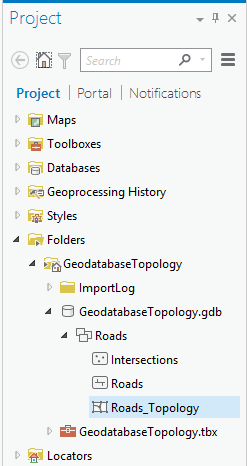

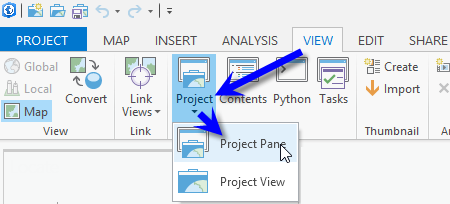

  1.  Open the Project pane.Open the Project pane: View tab > Project button > Project Pane
  2. Expand the nodes under Folders to see Roads_Topology. This is where the geodatabase topology is stored in the project.
    The source of the geodatabase topology

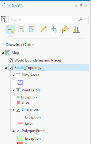

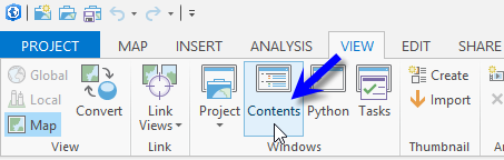

  3. Open the Contents pane. Open the Contents paneYou can see the topology was already added to the map.The topology in the map's Contents pane

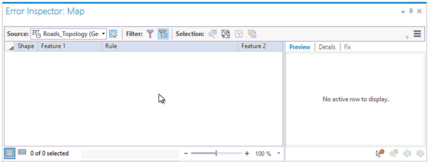

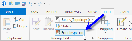

  4. Open Error Inspector.

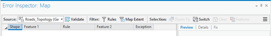

    You will see the Error Inspector: Map pane. “Map” refers to the name of the map view the topology is in.
    Error Inspector pane

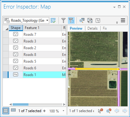

  5. Use the inspector to address topological errors based on the two predefined rules, which are: roads can’t overlap and road endpoints must be covered by intersection points. Here is a looped animation, which begins after the blank screen, showing how to validate the topology and fix errors:
    Animation loop of interaction with Error Inspector
    The animation loop begins after the blank screen. Click for a larger view.

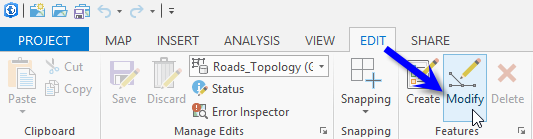

    Another way to inspect and address topology errors is by using the Modify Features pane.
    Opening the Modify Features paneThe topology tools are the last group of tools on the Modify Features pane. They work much like the ones on the Error Inspector pane.Topology tools in Modify Features

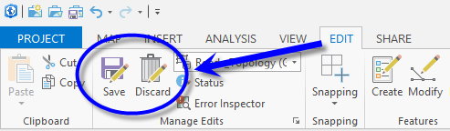

  7. Regardless of whether you use Error Inspector or topology tools on the Modify Features pane, you’ll need to save or discard your edits.
    Save or discard editsDiscard them if you want to experiment more with the same errors. If you’re familiar with editing, try creating your own road features and validating the topology as you go.
