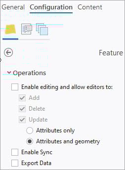

The following screenshot shows the editing and sync settings the analyst configures when publishing in ArcGIS Pro:
Editing and sync operations are not checked
Editing and sync are not enabled on the first web feature layer.

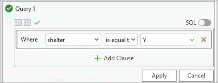

3.  The analyst uses the drop-down lists in the definition query pane to construct the query. Clicking Apply saves the query definition. With this definition query applied, only features that have a bus shelter will be available in the web feature layer.
Query defined to return features with shelters.
A query defined to return features with bus shelters.

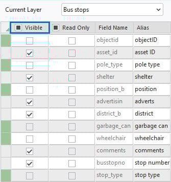

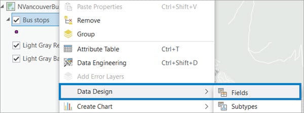

6.  To simplify the attribute table and remove fields that the maintenance workers don’t need, the analyst hides some of the fields. The analyst opens Data Design > Fields from the Bus stops layer in the Contents pane in the map.
Open Fields view from the map layer
The option to hide fields is available in Fields view only when opened from the map layer.
7.  The analyst unchecks boxes in the Visible column to hide those fields. Hidden fields will not be included in the web feature layer.
In the following example, the analyst has hidden multiple fields that the maintenance crew members do not need.
Uncheck Visible to hide a field
To hide a field, the analyst unchecks the Visible check box associated with the field.
As shown above, fields with altered properties are marked green in the Fields view window to indicate changes were made.

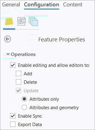

10. The analyst disables editing but enables sync so that the maintenance crews can take the web feature layer offline.

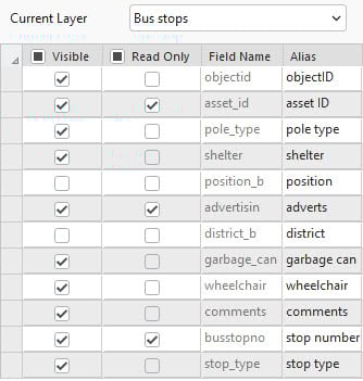

4.  The inspectors will edit their web feature layer to record what inspections they perform and when. However, a few fields in the bus stop layer should not be edited by the inspection crews. To prevent edits from being made, the analyst checks the Read Only check box for those fields in the Fields view of the map layer. Additionally, the analyst makes some of the bus stop layer fields visible again for the inspection workers.
The screenshot below shows the read-only and hidden fields in the bus stops layer that the inspectors will use:
Visibility and read only settings for bus stops for inspectors
Inspectors need access to more fields than the maintenance crew, but certain fields cannot be edited.
5.  The inspectors check existing bus stops in the field, so they do not need to add or delete bus stop features. Therefore, the analyst configures the editing settings to allow only attribute updates. To support working with the layer offline, the analyst also enables sync.
Editing attributes and sync enabled
Inspectors will update attribute values and take the web feature layer offline.
