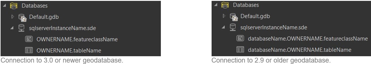

What differences can I expect after upgrading?
  • Geodatabase system tables no longer store the database name.
  • Tables and feature classes will no longer display the database name as part of their fully qualified names in ArcGIS applications.

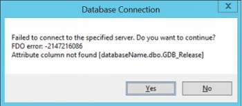

  • Connections from ArcGIS clients older than ArcGIS Pro 2.3 or 10.7applications will fail to connect to geodatabases that have been created or upgraded using ArcGIS Pro 3.0 or ArcGIS Server 11 and subsequent client releases.

Reminder that ArcGIS clients older than ArcGIS Pro 2.3 or 10.7 applications will no longer be able to connect to geodatabases that have been created or upgraded using ArcGIS Pro 3.0 or ArcGIS Server 11 and subsequent client releases.
