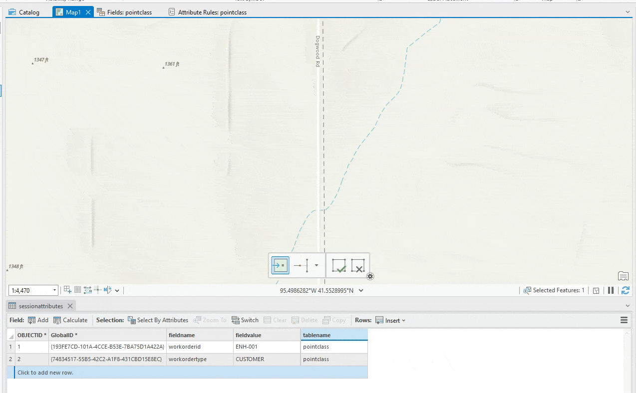

Here is an example of what we are building:

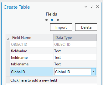

To do this, create a mobile geodatabase and then create a table named sessionattributes with three fields:
  • fieldname of type text, this will have the field name that we want to store.
  • fieldvalue of type text, this will have the value of the field.
  • tablename of type text, this will have the table name that this field belong to.
Example of the table schema used to store session attributes

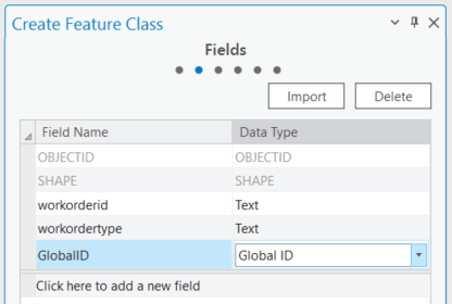

Next we create a point feature class with two fields:
  • workorderid of type text, this is the workorder Id of the feature being created.
  • workordertype of type text, this is the type of the work order.
Example schema of the point feature class

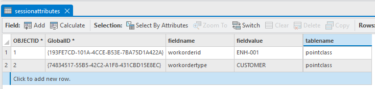

Let’s now insert two session attributes in the table, one for workorderid and one for workordertype.
Example attributes entry in the table.

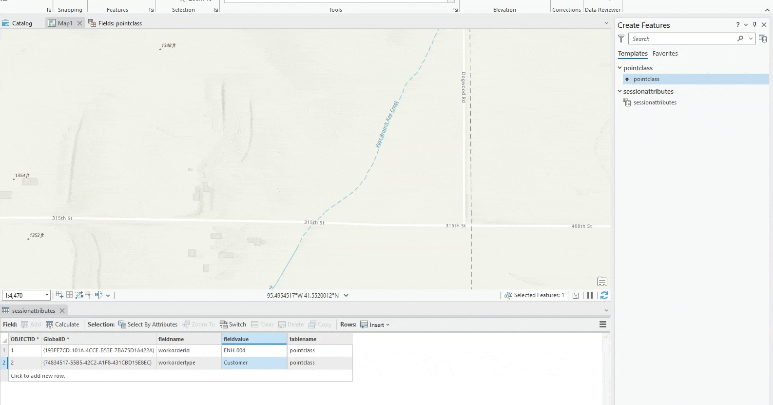

When supporting variables, you want an easier way for the user to edit these attributes without having to go to the session table for editing every time. I thought a good way to override the variables would be to let the user explicitly set them in the template while creating the feature. If the user specifies attributes,  we use them and update the session attributes table with them.  If the user didn’t provide an attribute we use the ones already in the table.
Here is how it works now:
And the updated rule:
