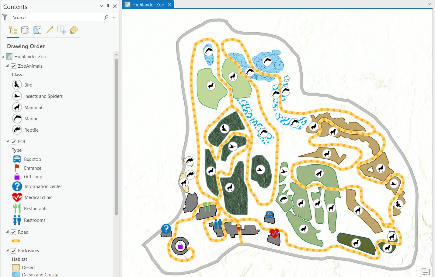

Highlander Zoo map in ArcGIS Pro

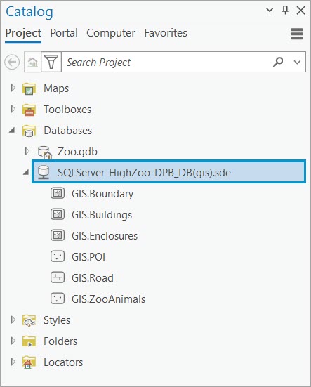

The zoo dataset is stored in an enterprise geodatabase. This allows multiple editors to access and edit the data in the same time in an isolated environment.
Highlander zoo enterprise geodatabase

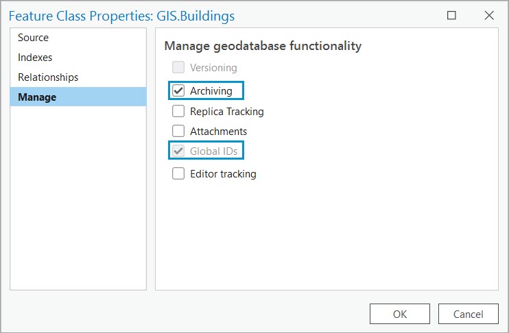

The registration type for the zoo data is nonversioned. This is because the organization doesn’t need conflict detection and doesn’t have the resources to perform version administration tasks. To take the data offline through feature service sync to make edits when disconnected from the network, the following capabilities need to be enabled on each feature class:
  • Archiving—Required to take the data offline and track historical data
  • Global ID—Required for the publishing process
The Manage tab
The Manage tab

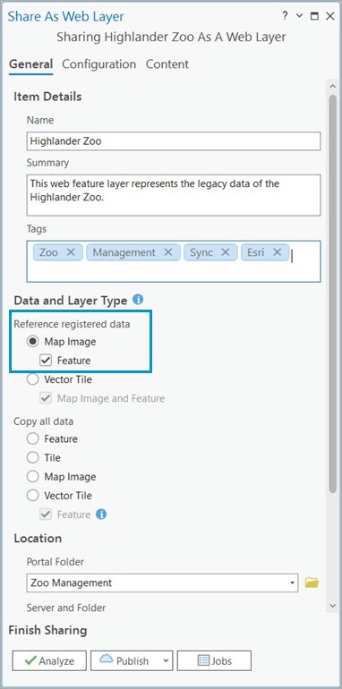

Share the zoo data as a feature service to ArcGIS Enterprise by referencing a registered data store. By publishing the data to reference a registered data store, we ensure that any edit made to the feature service will automatically reference back to the enterprise geodatabase, and vice versa.
Share zoo data by referencing a registered data store

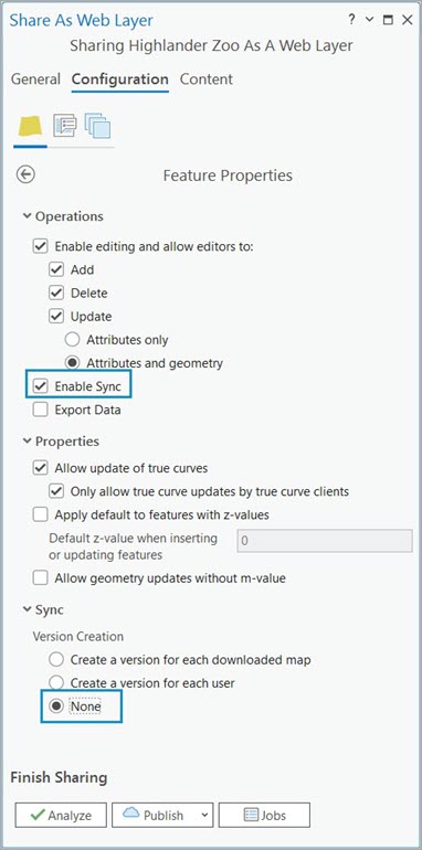

Finally, to make the data available for download on employees’ local devices so they can edit it when disconnected from the network, the Enable Sync capability must be checked on the feature service. Because the zoo datasets are not versioned, the version creation option must be set to None.
The Enable Sync capability
This means that anytime an editor accesses the feature service and takes it offline, it downloads the most current representation of the data from the geodatabase. Once the edits are made, it connects back to the network, and the edits are synched directly to the geodatabase. Because the data is not versioned, there is no conflict detection. This means that the editor who last synchronizes their changes will have the edits honored in the geodatabase. To account for this, non-overlapping offline areas will help.

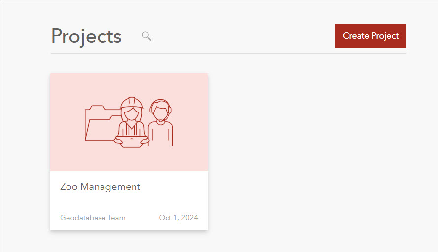

In ArcGIS Workforce, a new project named Zoo Management has been created.

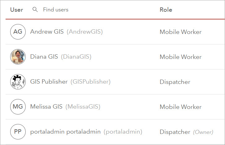

The project users are divided into two categories. The mobile workers are the zookeepers performing the tasks and the dispatchers are the zoo supervisors that assign and review tasks.

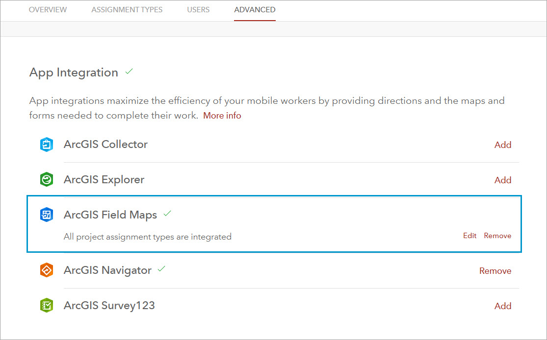

Under the Advanced capabilities, ArcGIS Field Maps has been integrated with the project to allow workers making edits to the zoo datasets.

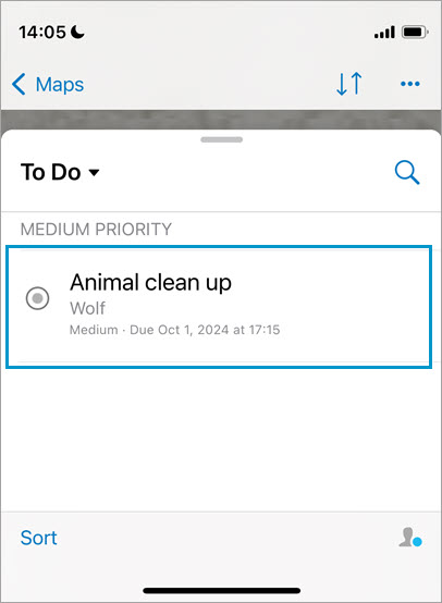

In the project view, under the To Do list, the Animal clean up assignment is listed as the upcoming task.
Assignment sent to mobile worker

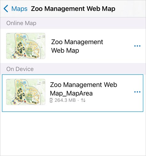

The nonversioned with archiving enabled registration type supports both online and offline editing. Therefore, once the ArcGIS Field Maps opens on the mobile device, the zookeeper can choose between the online or the on device offline map, depending on the network availability. If the online map is selected field edits will automatically synchronize with the geodatabase once submitted by the mobile worker. For this workflow, the offline map is selected.
Open offline map from local device
The offline map area has been defined when ArcGIS Field Maps was integrated with the ArcGIS Workforce project. Using Field Maps Designer multiple offline areas can be created as needed. This is particularly important as this registration type doesn’t support conflict review. In this case the editor who last synchronizes will have their edits honored in the geodatabase. To avoid overwriting offline edits, multiple non-overlapping offline map areas can be created and assigned to specific mobile workers.

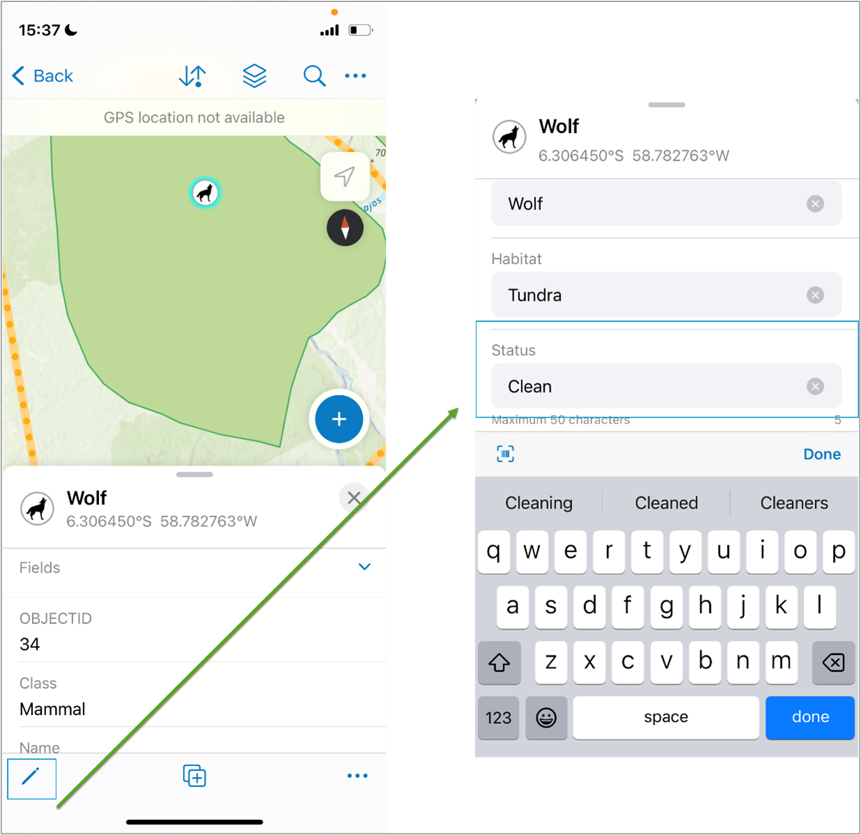

In the Zoo Management offline map, the zookeeper locates the wolf sanctuary and, using the Editing tool, changes the Status field to Clean.
Making an offline attribute edit

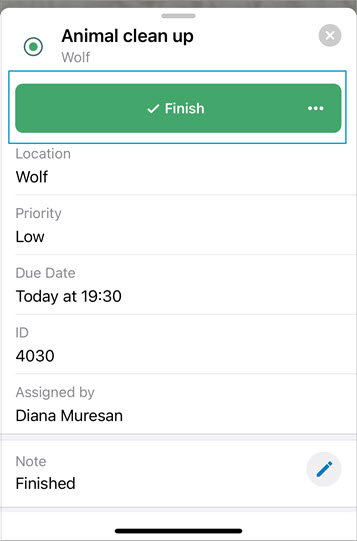

Once the edit is saved, back to ArcGIS Workforce, the zookeeper adds an appropriate note and marks the assignment as Finished.

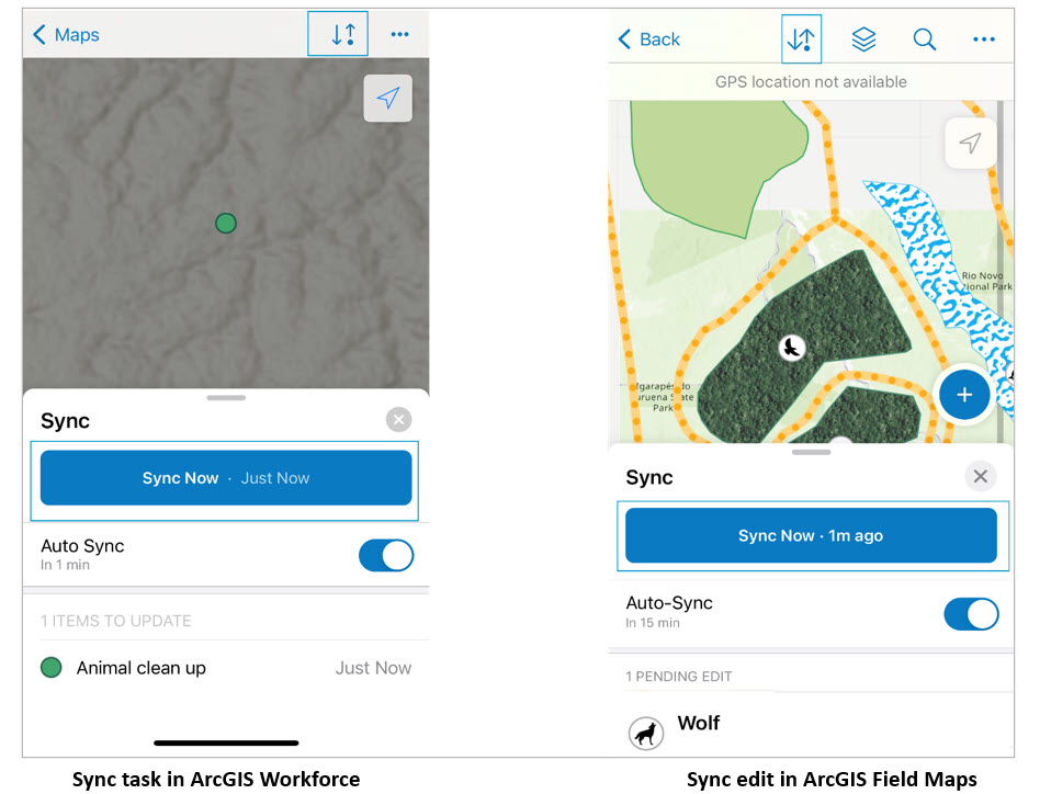

Synchronize offline changes
When the zookeeper downloaded the ArcGIS Workforce project and made edits to the offline map area in ArcGIS Field Maps, the edits were made to a local copy of the data downloaded on the mobile device. Therefore, the offline edits are available only on the mobile device. To make the edits available to the entire organization, the zookeeper must synchronize the offline edits back to the enterprise geodatabase.
Once connected to the network, the zookeeper synchronizes both the Workforce assignment, and the edit made to the Wolf feature in ArcGIS Field Maps.
