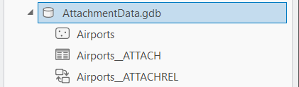

A feature class or table that has been enabled for attachments has three items:
File Geodatabase showing an enabled for attachments feature class. An attachment table and relationship class are used to manage associated attachments.
  • Feature class or table
  • An attach table (same name as the dataset with an appended __ATTACH)
  • A relationship class (same name as the dataset with an appended __ATTACHREL)

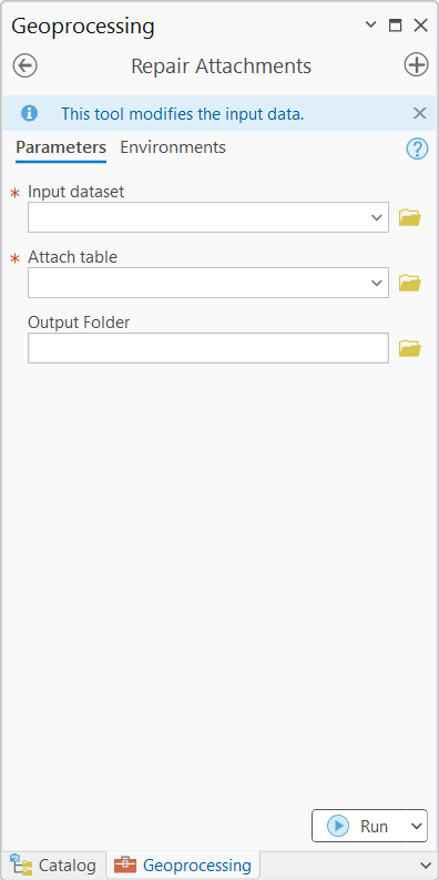

Next, fill in the parameters and run the tool.
7. Double-click the tool and fill in the parameters.
8. For the Input dataset parameter, select Airports.
9. For the Attach table parameter, select Airports__ATTACH.
10. Optionally, for the Output Folder parameter, if you chose to download all attachments during the repair, browse to a folder to save them. If you need more options for exporting attachments, leave this parameter blank and use the Export Attachments tool after the sample tool completes the repair.
11. Click Run.

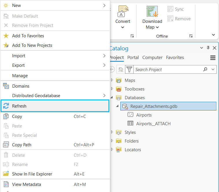

Screenshot showing the Catalog pane Context Menu to Refresh the geodatabase.
The Catalog pane context menu displays the Refresh button to refresh the geodatabase.
When the tool completes, a refresh shows the updated items in the geodatabase.
Screenshot of Catalog pane with original data and attachment table in geodatabase on the left and updated items after running the sample tool in the geodatabase on the right after refresh.
The Catalog pane is shown with the original data and attachment table in a geodatabase on the left, and after you run the sample tool, updated items appear in the geodatabase on the right after refresh.
The tool renames the original ATTACH table, enables the feature class for attachments, and recreates both the ATTACH table and the relationship class. Following this, the tool creates a match table in the geodatabase to reload the data. Use the match table for future reference or delete it.
At this point, the repair of the attachments to the dataset is complete. The original attachment table (with ORIG appended) can now be deleted.
