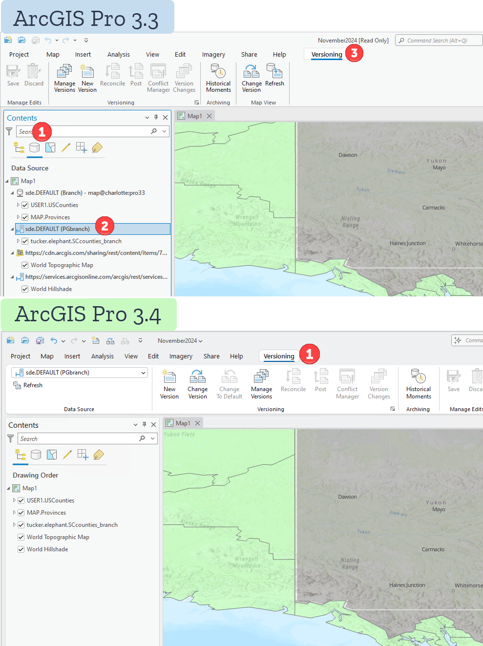

We’ve made changes in the ArcGIS Pro 3.4 release to improve both the usability and accessibility of the Versioning contextual tab.
If you’ve worked in ArcGIS Pro 3.3 and earlier versions, you know that the Versioning tab was contextually displayed after first activating the Data Source tab of the Contents pane, and selecting a supported versioned data source. During editing workflows it was easy to occasionally lose the context of the Versioning tab when a different tab needed to be activated.
Starting at ArcGIS Pro 3.4, the Versioning tab is contextual based on the map contents—this means it will be available if your map contains layers from a data source that supports versioning.

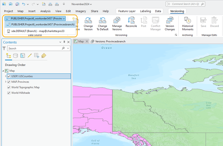

Data Source group and dropdown
You’ll notice that a new group labeled Data Source has been added with a dropdown. The contents of this dropdown menu include the supported versioned data sources of the map–this aligns with the workspaces in the List By Data Source tab of the Contents panes. Note that selecting the data source workspace from the Contents > Data Source tab will continue to set the active data source as well.
🔍Pay close attention to this dropdown when your map contains multiple supported data sources, as the active data source set is used for all the tools and commands on the Versioning tab.
Data Source dropdown
The Data Source dropdown contains multiple supported data sources from the map layers. Use this to select the active data source for use with commands on the Versioning tab.
Change To Default command
We’ve also added the Change To Default command to the Versioning group, which was previously only accessible via the Data Source context menu. This can be used to quickly toggle the data source back to the default version.
Adjustments to the location of commands
  • Refresh–located directly under the Data Source dropdown – refreshes the layers for the active data source
  • Save / Discard—moved to the right side of the ribbon
  • Change Version—moved beside the Change To Default command in the Versioning group

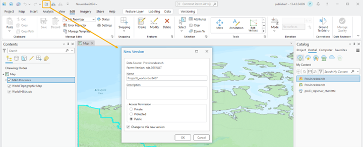

Use the quick access toolbar to create a new version
When connected to an ArcGIS Enterprise portal – I can add data from a feature service containing branch versioned datasets to my current map. Because the Version Management capability is enabled for this service, the Versioning tab is contextually available when the web feature layer is added to a new map.
Quick Access toolbar - New Version
You can customize the quick access toolbar by adding a few commonly used versioning commands for easy access.  Even with the Edit tab active, you can click on the New Version command on the Quick Access toolbar to launch the New Version dialog. After entering the version name, description, and access permission, check the option to automatically change to this new version for the data source. With this, you are able to quickly start an editing workflow where your edits will be isolated within your user version.

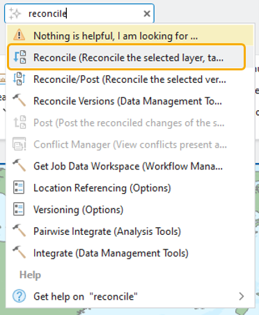

If you didn’t want to leave the current tab you are working in after making a few edits, simply use the Command Search for the specific versioning command and launch it from there.
Command Search - Reconcile
Command Search shows the Reconcile command is active when searching from a map view that has the data source connected to a user version.

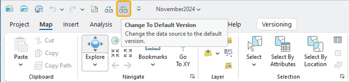

Since the data source is set for the current map view automatically based on the layer contents and you are connected to your user version, the Reconcile tool is active when we search via the command search. You can reconcile and post your edits, then use the Change to Default command added to the quick access toolbar to toggle back to the default version and see your posted edits.
Quick Access toolbar - Change To Default
