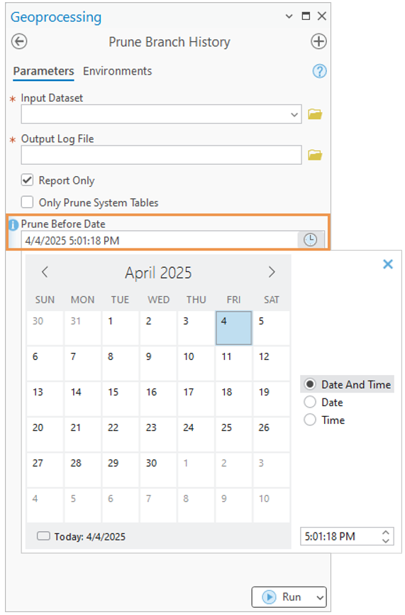

Prune Branch History geoprocessing tool
We’ve added a new geoprocessing tool to prune the branch history table. I know this is something people have wanted for a while.
As you make edits to branch versioned data, the business table tracking those edits continues to grow. In cases in which a substantial number of edits are being made, this can eventually lead to performance degradation in editing and querying time. There were requests on the Esri Community pages to offer a trim tool for branch management, and we’re happy to oblige with the Prune Branch History tool in ArcGIS Pro 3.5.
The tool has options for precisely when you would like to make your cut and how to manage the historical data. Read Elaine and Melissa’s Prune like a pro blog to learn how best to use the new tool.

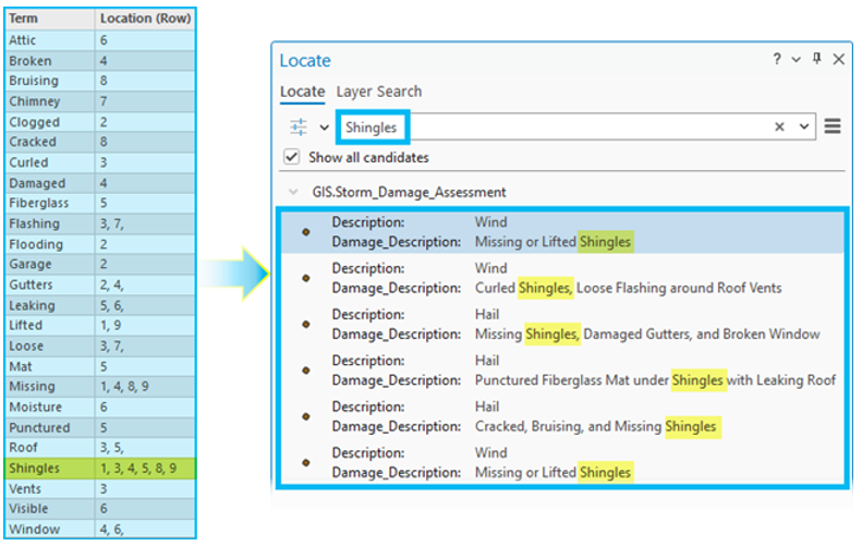

Full-text indexes
A new geoprocessing tool, Add Full-Text Index, allows you to create full-text indexes in your mobile or enterprise geodatabases. These are like attribute indexes but for improving query response when searching large volumes of text for specific words or phrases.
