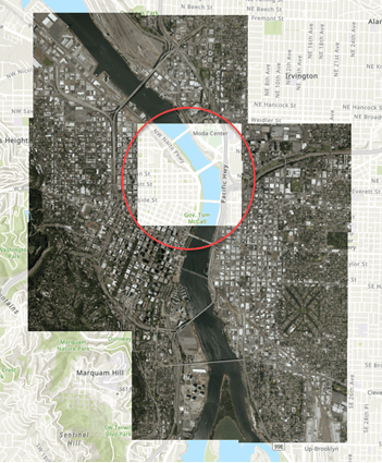

In this case, the mosaic dataset of the Willamette River appears to be missing an image.  But upon further inspection, all the items were loaded into the mosaic dataset. However, one of the items seems to be in an incorrect location.
Missing mosaic dataset item

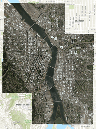

georeferenced mosaic dataset item
NOTE: The source has not been updated (only the mosaic dataset). If you need your source to be updated, you can export your georeferenced item and replace the source. To replace the source, overwrite the source imagery with your newly exported raster.
