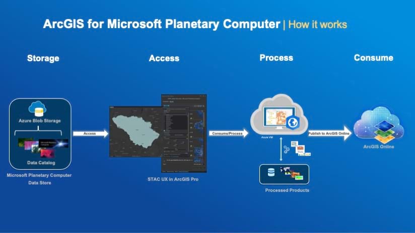

What is ArcGIS for Microsoft Planetary Computer?
ArcGIS for Microsoft Planetary Computer is offered as an Azure solution template that lets users generate a preconfigured ArcGIS Pro virtual machine instance in the same cloud region as the Planetary Computer (Azure Europe West). This Pro instance provides the same desktop analytic environment the user has licensed for ArcGIS Pro—including raster analysis tools (available with ArcGIS Image Analyst), geoprocessing tools, publishing tools, and any extensions the user has purchased and installed. Users launch this virtual Pro instance on demand within their existing Azure environment, avoiding the need to install additional software.
ArcGIS for Microsoft Planetary Computer benefits include:
  • Ability to leverage the ArcGIS platform to directly connect to the Planetary Computer data catalog of analysis ready datasets. You can use the pre-configured STAC tools to easily query and filter the Planetary Computer data catalog by location and time.
  • Access to configurable CPU/GPU and storage settings needed for advanced analysis techniques over large geographic areas, such as change detection, time series analysis, and deep learning. Use the pre-set machine controls to prevent accidental overcharging when processing takes hours to complete.
  • Incorporate advanced Esri Geospatial Artificial Intelligence (GeoAI) tools in your project to perform land cover classification and object detection.  The ArcGIS virtual image includes pre-installed deep learning libraries and processing templates that have been customized for the Planetary Computer data catalog.
  • Work based on your preferred environment, with no-code options using raster functions from the GUI, semi-automated processing with Model Builder, or full-code via the Python API. Perform on-the-fly processing or apply it globally and persist the results.
  • Easily share out insights with members of your organization, decision makers, or the public. Use interactive custom applications and storytelling tools that help translate your analysis results into easy-to-understand content.
