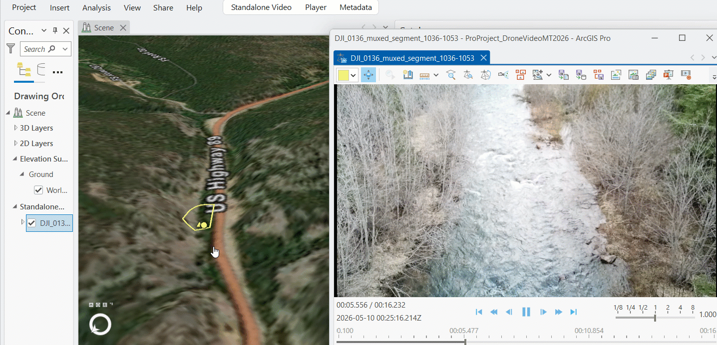

Short segment of video survey over Belt Creek (central Montana) - drone video after multiplexing, via Motion Imagery tools in ArcGIS Pro
Video survey over Belt Creek (central Montana)

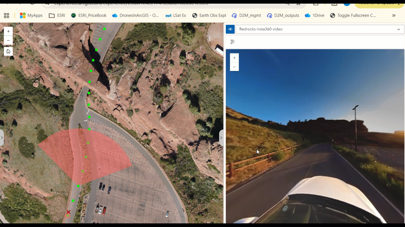

Brief video clip of 360 degree video in Red Rocks Park, Colorado - oriented imagery layer shown in Experience Builder

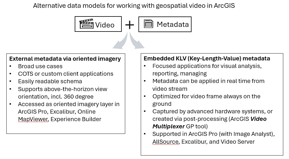

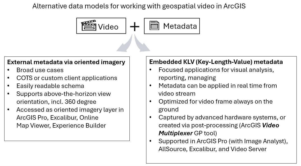

Diagram of the two data models in ArcGIS for geospatial video
