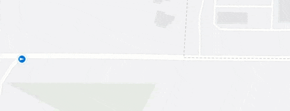

Device location marker symbol moves across the map view

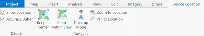

With your device’s location enabled, ArcGIS Pro’s GNSS navigation tools become available to you, as shown below.
Device Location toolbar
The Device Location toolbar in ArcGIS Pro 2.7

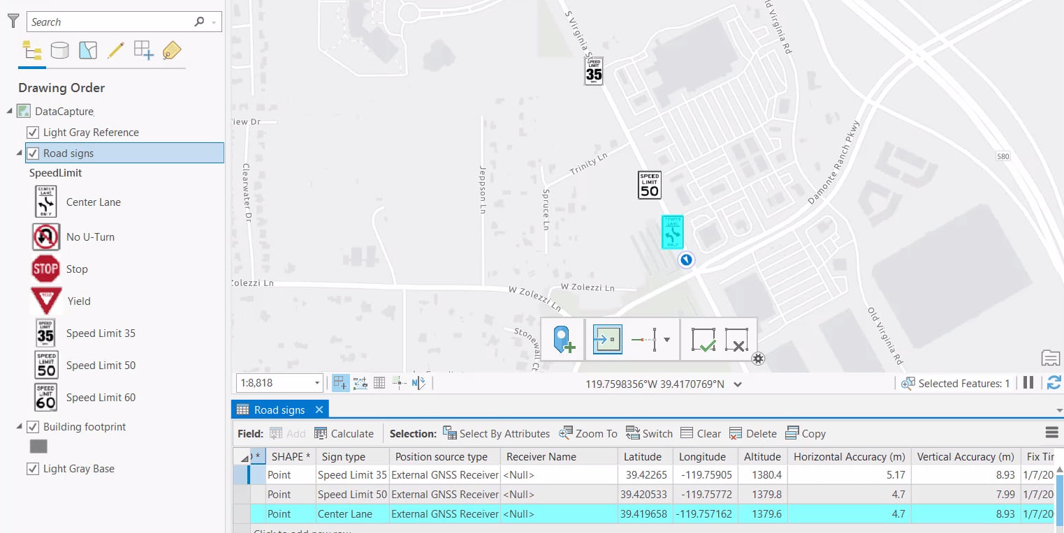

From here, we can begin to capture and collect data in the field. This example deals with collecting road signs on a busy boulevard. We want to record the location of these signs before starting a major construction effort. Later, we will send out traffic engineers to investigate their status, condition, and retroreflectivity. We need to maintain a high level of accuracy throughout the process so we can replace damaged or missing signs after the project completes, if necessary.

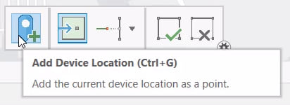

We can add these locations as points to our feature class in the view without interfering with the rest of the application. This closer, better integration with ArcGIS Pro editing tools is one of the newer capabilities of GNSS data collection in ArcGIS, and one of its largest benefits. The construction toolbar contains the Add Device Location button to add the point to the feature class. If you are creating line or polygon features, click this button to add each vertex until the sketch is finished.
The Add Device Location button appears in the editing construction toolbar when location is enabled in the view.
Note the blue marker symbol, which indicates our device’s current location. We’ll need to pay attention to the accuracy level indicators of our location in the map. An accuracy buffer, which can be turned on or off from the Device Location toolbar, appears as a gray circular outline that grows or shrinks in size. The marker symbol turns red if we exceed the accuracy threshold, and a red exclamation point appears on the Add Device Location button. Nothing prevents you from adding points while exceeding the threshold, so bear this in mind.
The feature class’ attribute table captures ID information only – but the GNSS device certainly has more data to share than this! It is good practice to run the Add GPS Metadata Fields geoprocessing tool on your feature class before you begin collecting data. This tool adds collection fix time information, latitude/longitude/altitude, horizontal and vertical accuracy, and other fields, as seen below.
Point features added from GNSS devices
Add the current location of your GNSS device to your point feature class to record important locations, such as road signs.

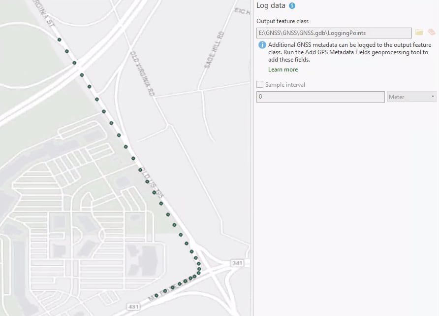

In other kinds of projects, you need to track the changes in the device’s location over time. This process must happen automatically, and it cannot interfere with the other work you’re doing in the application. To support this, ArcGIS Pro can collect locations automatically by writing them to a point feature class. In the Log Data tab of the Device Location pane, input a point feature class (use the Add GPS Metadata Fields geoprocessing tool if desired) and click Run. While you’re working in other parts of the application, ArcGIS Pro uses background processing to collect and log the location of the device. You can stop and restart logging, as needed. If you’re done logging, you can add the layer to the map or scene and use its time metadata to play back the changes if necessary.
Logging device location data as points
