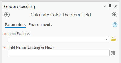

  1. Search for the tool or find it in the Cartographic Refinement toolbox (Cartography Tools)
  2. Select the input features you wish to color and the name of the field (existing or new) that will contain the new values
  3. Run the tool and it will populate the chosen field with an integer value, e.g. 1 through 5
  4. Now, open the Symbology options, and choose to style by Unique Values. Choose the updated integer field and a suitable color scheme. That’s it!

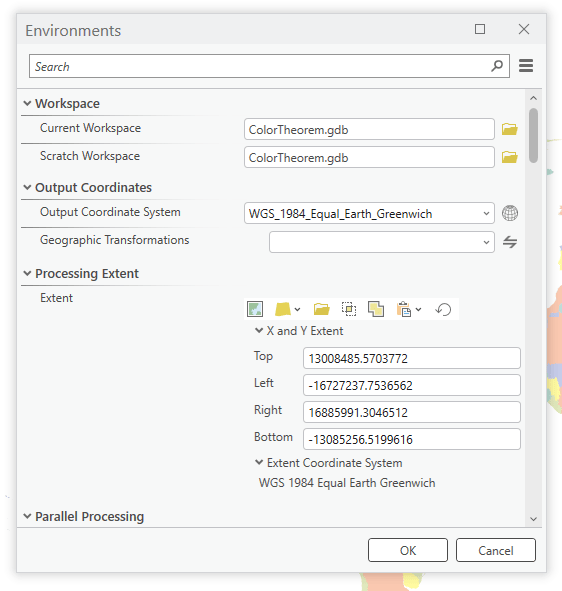

If you wish to reduce the number of colors, it is possible to edit the field for manual fine-tuning after running the tool; or run the tool several times on different geographic extents. To set the processing extent, go to the Analysis ribbon and under Geoprocessing choose Environments.
