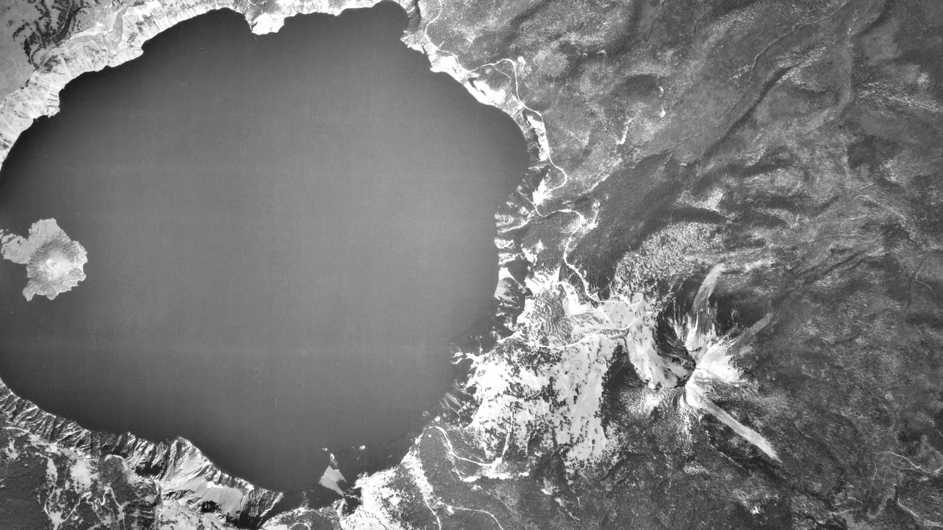

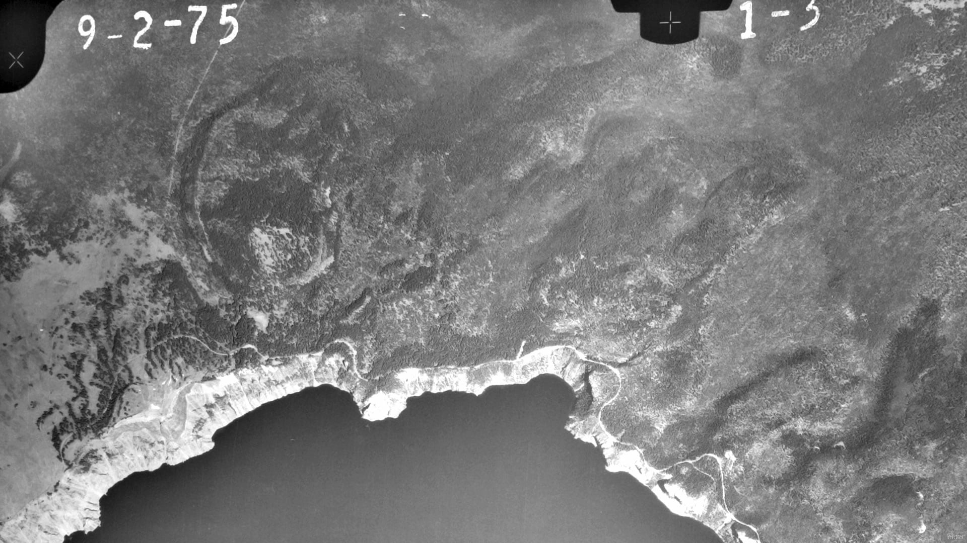

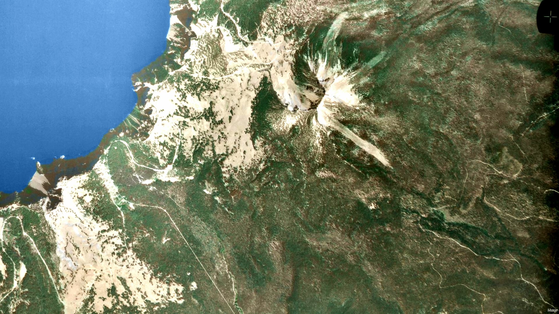

Here are some examples, from the glorious Crater Lake, Oregon…
USGS airphoto from 1975
Colorized USGS airphoto from 1975
