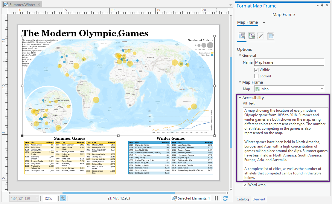

Step 2: Add alt text
Once you’ve designed your layout, it’s time to add alt text. Alt text is descriptive text used for graphics and charts that a screen reader reads. If you are trying to read a document and  can’t see the map or charts, a screen reader reads out the alt text for those items so you understand the information without seeing it. In Pro alt text is available for map frames, charts, and pictures. Scale bars, legends, north arrows, and graphic elements (rectangles, lines) are tagged as decorative items, meaning someone who can’t see could understand the document without hearing a description of these items. Decorative items don’t have alt text.
To add alt text open the Element pane, expand the Accessibility section and type in the Alt text. Remember, the alt text could be the only information someone has about the element, so be specific and comprehensive. Don’t just say “it’s a map” or “a bar chart” rather, explain the information being shown. Since scale bars, north arrows, and legends don’t have alt text you can explain the information they convey in the map frame alt text (or by using dynamic text on the layout itself).
A layout in Pro with a map frame selected. The Element pane is open and the alt text box is highlighted, showing where you can add alt text.

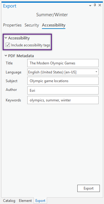

Step 3: Turn on tagging and add metadata
Next up, you need to export the layout to PDF. By default, exporting to PDF does not include tagging for accessibility. You need to turn that on separately by going to the new Accessibility section of the export pane and checking on Include accessibility tags. Here you can also fill out the PDF metadata, which is another important part of making a PDF accessible. Screen readers use this information to provide a better experience and support search capabilities.
The export pane for a layout PDF export. The accessibility tab is shown with populated metadata and the Include accessibility tags option checked
Step 4: Export
Finally hit the export button! The output is a PDF tagged for screen readers, with alt text and metadata.
