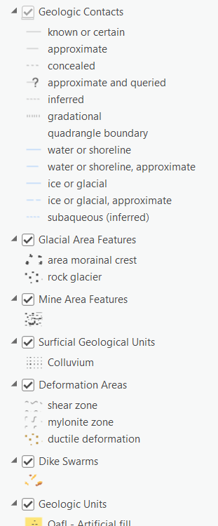

A snippet of geology symbols in the Contents pane.
If you've ever worked with geological symbols, then you know how long the list can get!

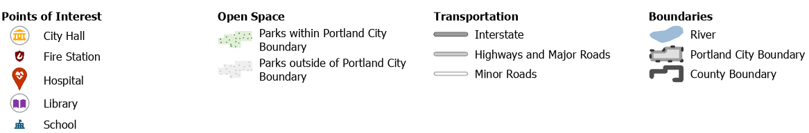

Here’s a common example to help depict how this tool is used. This map of Portland, Oregon, USA features custom symbology and an inset map of the downtown region. You’ll see a variety of colors, polylines, and point symbols. There are custom symbols and layout elements, some of which are built upon the default symbols included in the ArcGIS 2D style.
A zoomed-in view of the Portland map's legend.
It’s not an unfathomable number of symbols we’re working with, but it’s enough that it would take considerable time to save each one as a style item. And this is a theoretical map we’ve created; imagine a map with hundreds of unique symbols. It’s not worth the headache.

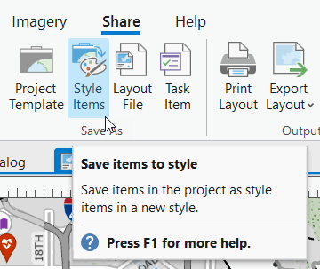

So instead, we will export all the symbols we have in our project. On the ribbon, click the Share tab, and in the Save As group, click Style Items.
In ArcGIS Pro 3.2 or later, on the Share tab, click the Style Items button.

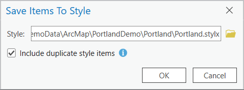

A dialog box opens where you can choose to save the new style, and whether you want duplicate style items to be included. This second option is referring to your map: do you want 10 instances of the same black point symbol saved to your style from every layer that uses it, or do you want just one copy? In some cases, you may want those duplicate items because you want to verify that the ‘blue’ is consistent or the ‘text’ symbols use the same font size. Any redundant duplicate items can be easily deleted from the style, so consider what your use case is.
The Save Items To Style dialog window.

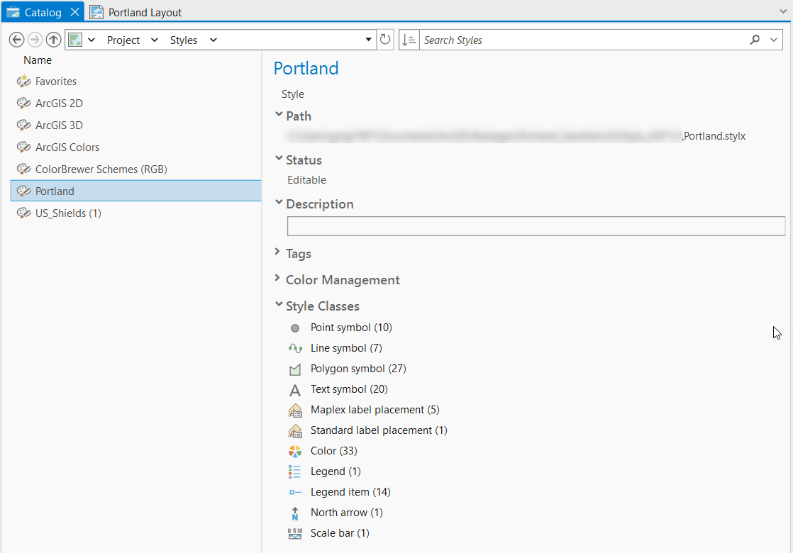

After the process is complete, the style is saved to the file path you specified. You can view it from ArcGIS Pro by opening the Catalog view. Going forward, you can overwrite the style with any updates to your symbols.
The resulting style can be found in the Catalog view.
