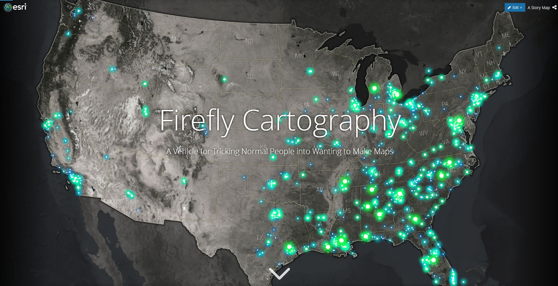

This story map will give you the lay of the land.

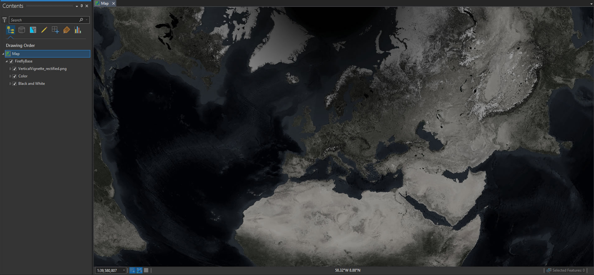

Ok, now we’ve got that all squared away, here is a resource for ArcGIS Pro users to get rolling on some firefly cartography. It is a mega-huge ArcGIS Pro project download (355MB what??) with all of the NASA imagery packaged up into it. So get the coffee maker rolling, hit download, and kick back. When you open it up, it will look like this…

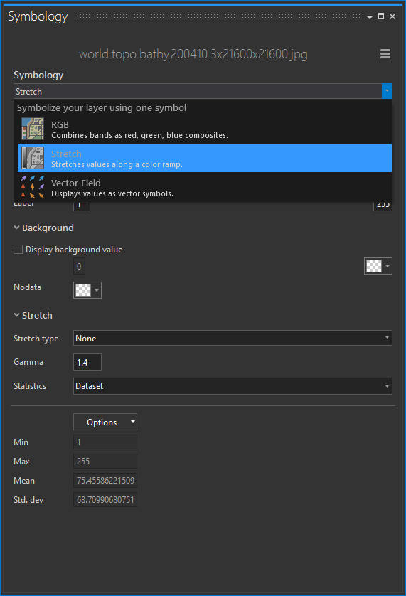

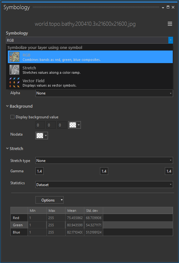

A hallmark of a firefly map is the dark, desaturated imagery basemap. The easiest, fastest, way I’ve found to do this (you could probably use a raster function, alternatively) is just make two copies of the imagery. The bottom layer is set to black and white and the top layer set to color. Here are the settings I used:

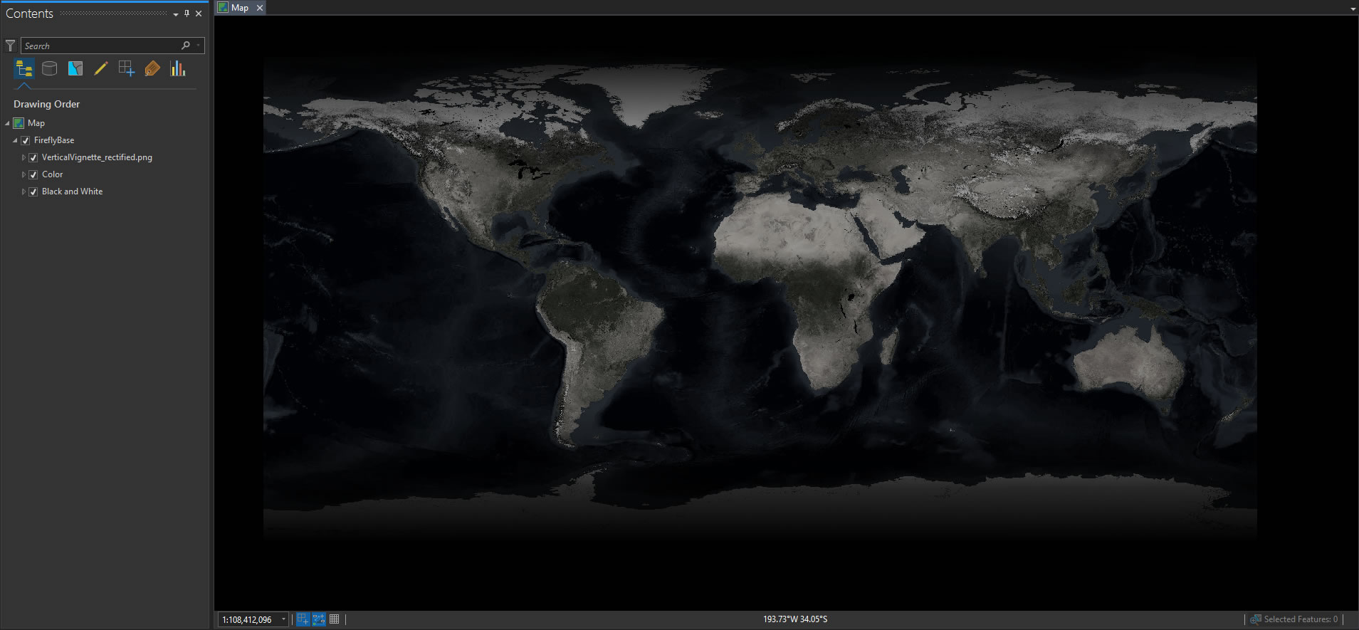

They look like this in the viewer. The group of black/white images I set to 40% transparent…

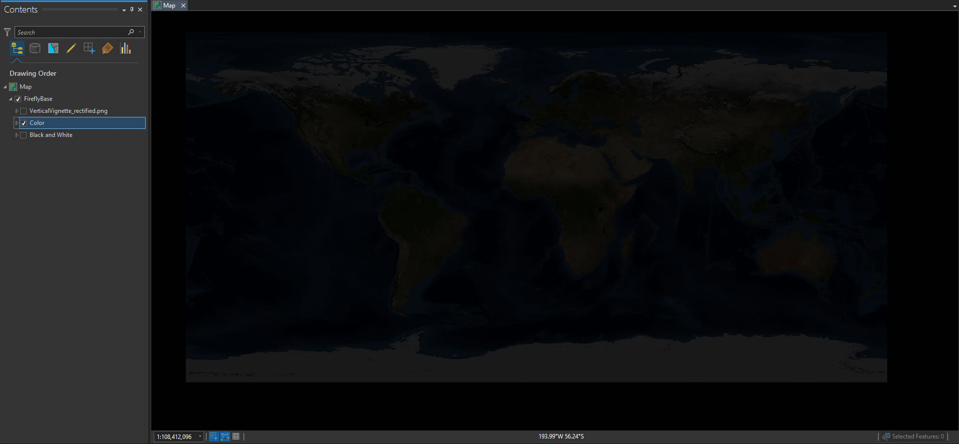

The color images have a transparency of 90%. Yeah, you can barely see them on their own, but they paint in just a bit of color for helpful (maybe dramatic) context over the gray-scale imagery.

Finally, I use a vignette layer to mute the bright whites of the polar regions. This vignette helps draw the eye into the map and frames the overlain thematic content in a sizzling sort of way.
I did not include a vignette for the left/right edges of the map because that falls apart depending on the projection used. Please, oh please, do not leave your map in this default equirectangular projection. Here’s a European Lambert projection, for what it’s worth…
