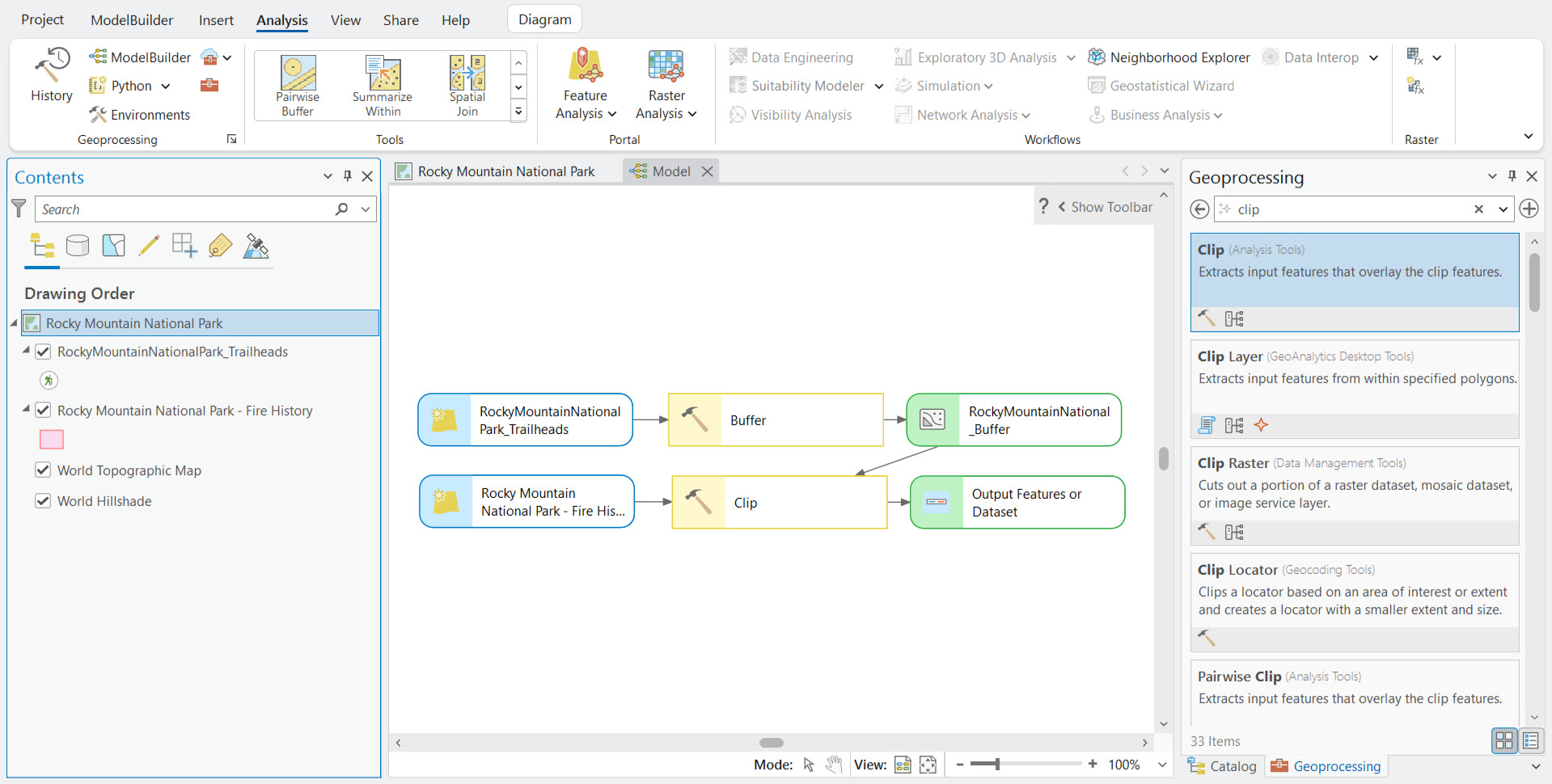

A completed model in the ArcGIS Pro interface
A model will appear as a View in the middle of the interface.

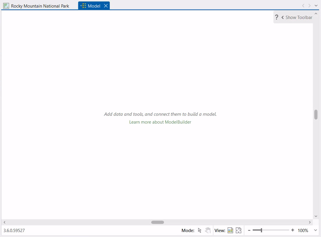

A blank ModelBuilder canvas
A blank canvas for building your model opens

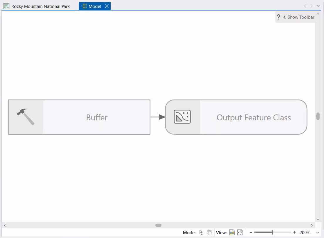

When you add a tool to a model by dragging it from the Catalog or Geoprocessing pane, its output element is also added, and both elements are light gray. In model parlance, gray means not ready to run.
Double-click each tool and set its parameters. A red asterisk next to an item in a tool dialog box means the parameter is required. Set tool parameters and pay attention to red asterisks.

ModelBuilder View with a tool added but not ready to run.
When you add a tool to a model by dragging it from the Catalog or Geoprocessing pane, its output element is also added. Both elements are displayed in light gray until the parameters for the tools have been set.

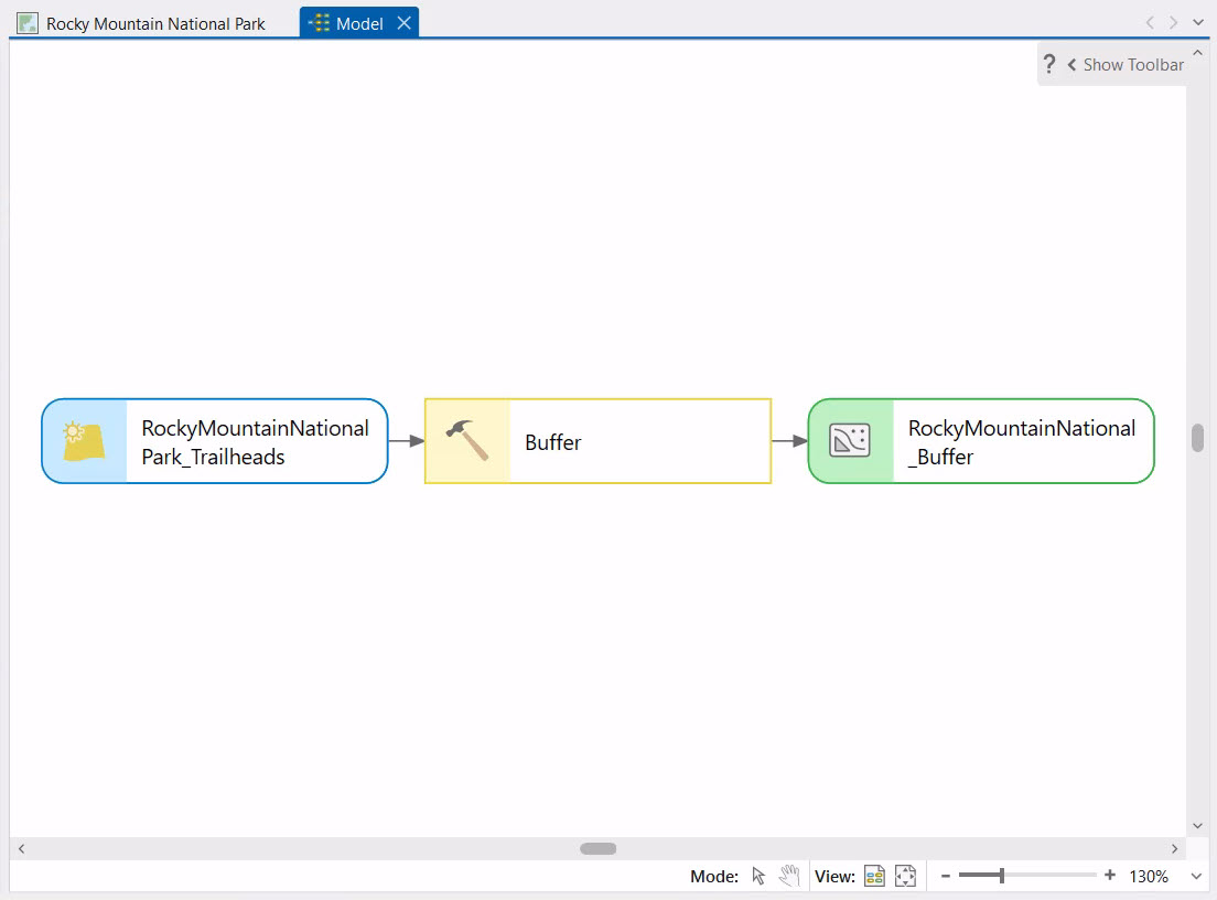

Once you click OK to set the tool parameters, the input element displays and the process colorizes.
Now that you have added your first tool to the model, add another, and use the output of the previous tool as input for the new one.
A basic model colorized and ready to run
When all the required parameters for a tool are set, it colorizes and is ready to be run.

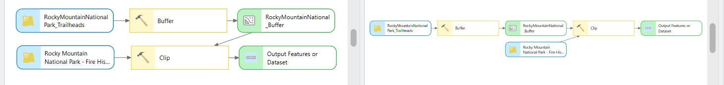

As you add processes, the model window may fill up. Use the Auto Layout and Fit to Window buttons to see the big-picture view and zoom in and out as needed.
Two views of the model showing the before and after of using the auto-layout button
Before (left) and After (right) of using the Auto Layout in ModelBuilder.
