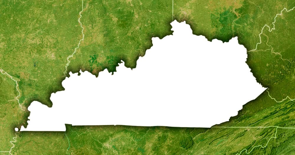

It’s a snazzy trick and maybe just the sort of flair that your map needs! And it’s simpler than maybe you’d guess. To give your area of interest a peeled edge effect, you just combine a dark gradient stroke that looks like a shadow with a light gradient fill that covers some of the shadow, then group them and apply a darkening blend mode.
Cheat sheet! White fill with a giant shadowy gradient stroke dragged beneath it.
Step 1: white fill with shadowy gradient stroke

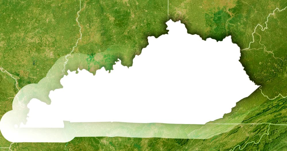

Then add a layer with an offset effect so it covers the shadow, and give it a linear gradient fill.
Step 2: Cover shadow with a white linear gradient
Then group these layers and give the group a darkening blend mode like Multiply (or Color Burn). The result shows only dark content, so the shadow appears to fade in at one edge.
Step 3: darkening blend mode to eliminate the lightness

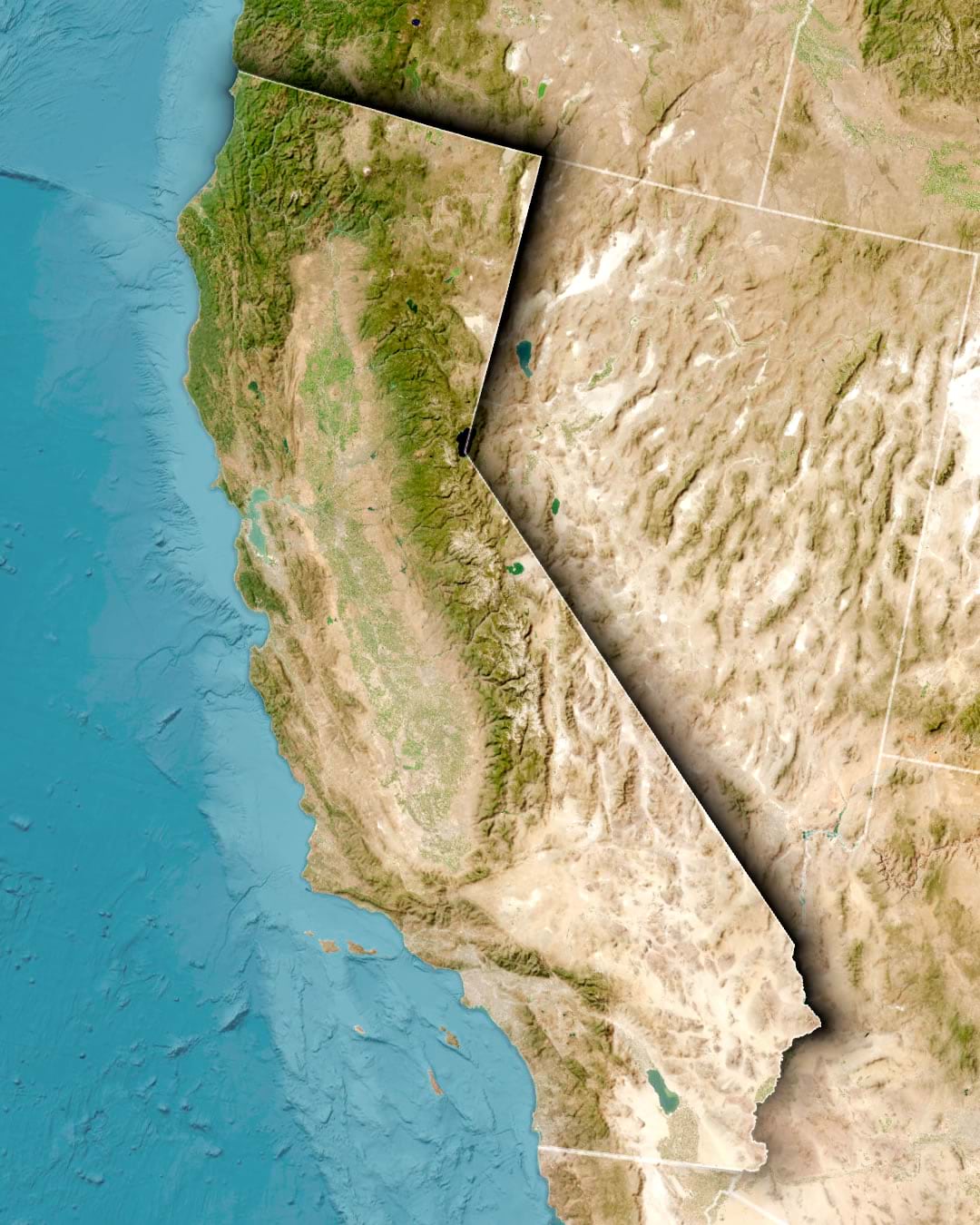

Here are some more states, to give you a sense of the aesthetic…
peeled edge effect applied to California

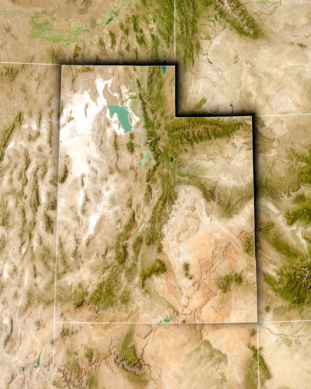

peeled edge effect applied to Utah

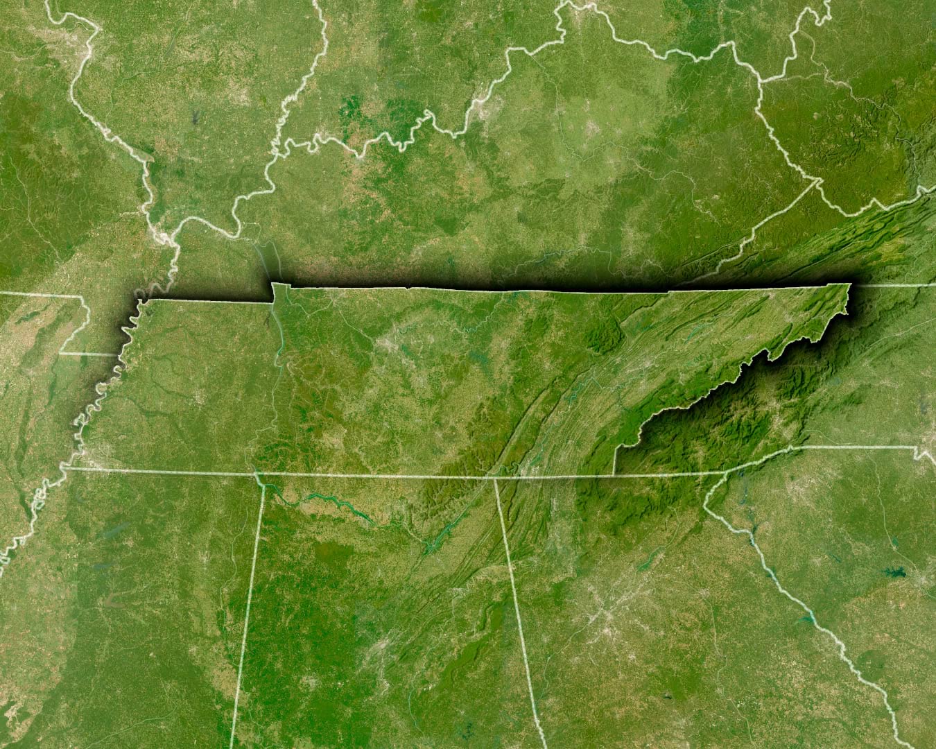

peeled edge effect applied to Tennessee

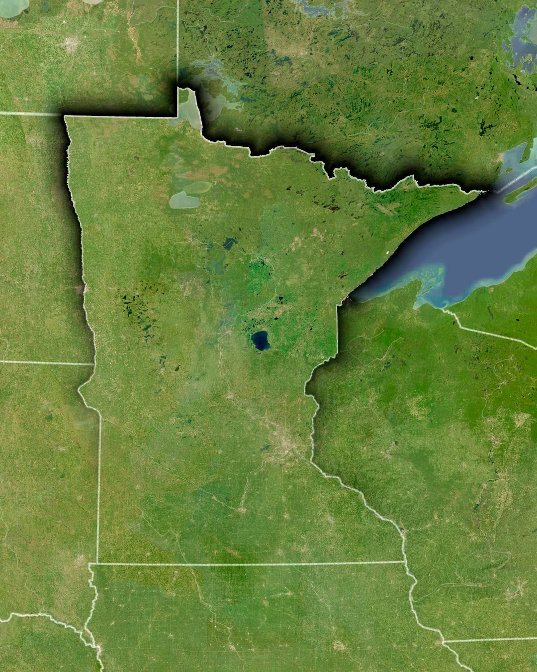

peeled edge effect applied to Minnesota

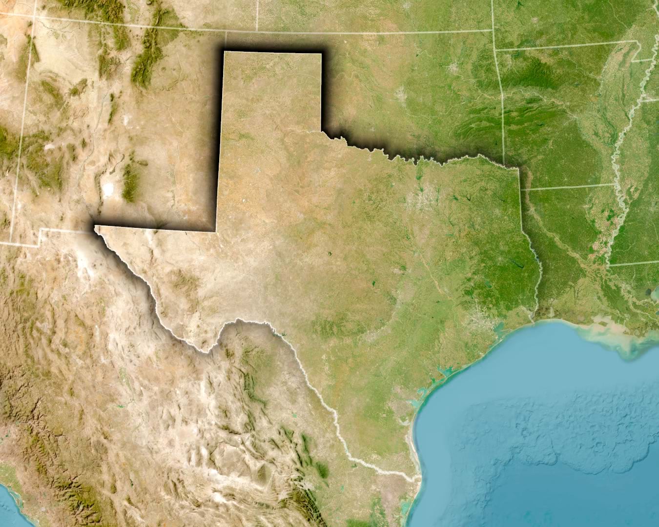

peeled edge effect applied to Texas

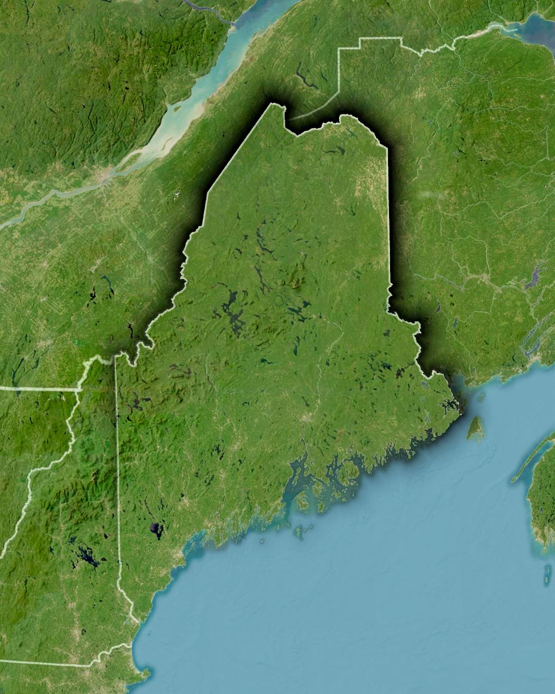

peeled edge effect applied to Maine
