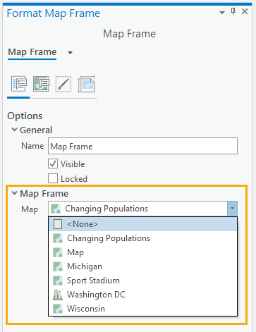

Recently I’ve been asked by people in a variety of GIS jobs about how to change the map used in an existing ArcGIS Pro layout. Thankfully, Pro provides a way to do this quickly. If the new map you want to use exists in the same project as the layout, all you need to do is change the map in the map frame.
How do you do that? Open the map frame properties by double clicking on the map frame in the Contents Pane, then in the Format Map Frame Pane, change the map selection. The map frame updates to show the new map.  AND all the surrounds pointing to that map frame, like legends and scale bars, update automatically as well! No need to redraw elements.
Picture of the format map frame pane, with the map dropdown highlighted.

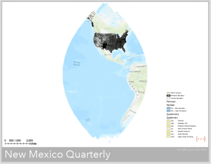

Sounds easy right? Usually it is, but sometimes when you change the map you get a weird map extent. Something like this:
A layout showing a sliver of the globe, but data is only visible for the US. The map extent is clearly wrong.
Yikes!
What happens is that when you pick a new map, Pro doesn’t know what extent you want that new map to show. The best guess the software can make is the full extent of the map. If you are using a basemap, that extent can be the whole world!

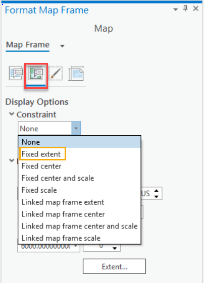

So how do you set a map frame constraint?
Just double click on the map frame in the Contents pane to open the Format Map Frame Element Pane, go to the Display Options tab (marked in red below) and set the constraint to Fixed Extent.
Picture of the Format Map Frame showing the Display Options tab and the Constraint drop down
Then change the map in the map frame, and voilà! Your new map draws at the same extent. You may want to take the map frame constraint off after changing the map. Or not. Whatever works for you!
