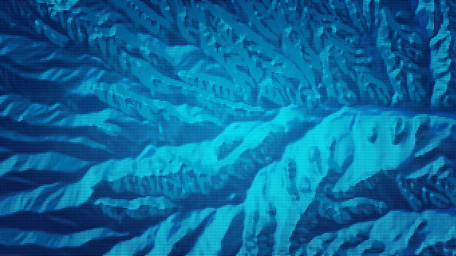

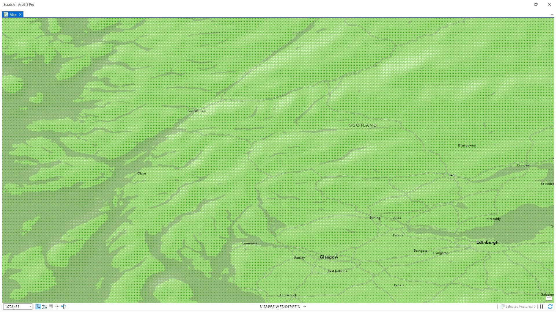

Well that’s it, friends! Try your hand at some pebbled hillshade. Here are a couple of examples…
blue pebbled hillshade
Green pebbled hillshade
