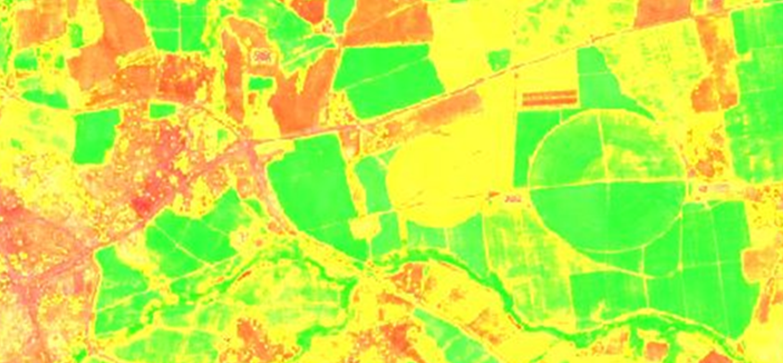

  • I derived the Normalized Difference Vegetation Index (NDVI) from the satellite imagery which is a measure of relative biomass that can be used as a proxy for vegetative health. Being able to quantify the health of the sugarcane on a field by field basis as we move through the growing season is paramount to being able to estimate the ultimate yield of the crop.

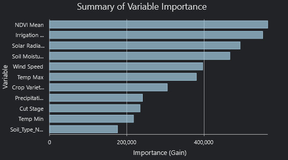

Not only did the model create successfully trained features, but it also performed well when run independently on the 2022 field data as well. ArcGIS also output many supplemental details about the regression analysis itself and how each variable fared during the model’s training. The chart of variable importance below illustrates that of all the variables I incorporated into my training data, the most important variables for predicting sugarcane yield in this region of interest are the field’s NDVI mean six months prior to harvest, its irrigation method, solar radiance, and the soil moisture.
Summary of Variable Importance Chart
NDVI Mean for each field was the most important variable in predicting yield

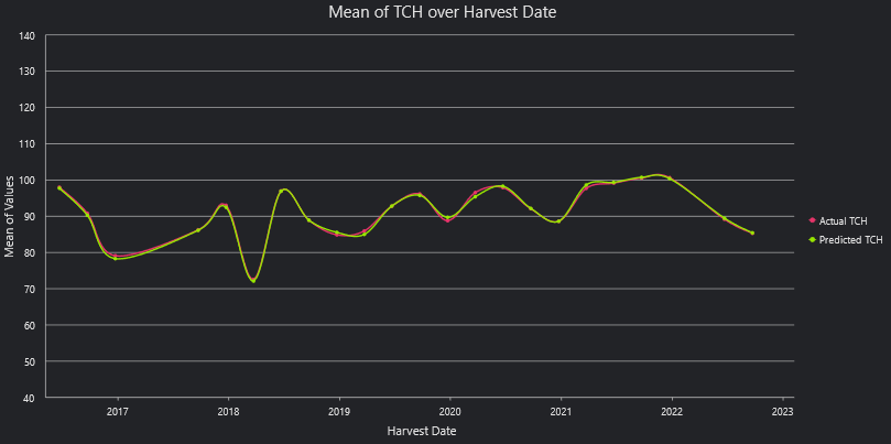

From a temporal perspective, I also compared the predicted annual yield means to the actual annual yield means for all my fields across nearly seven years. This illustrates how closely aligned the prediction is with the actual yield results.
Predicted versus actual harvest values over harvest date line graph
Predicted annual yield means compared to actual annual yield means over time
