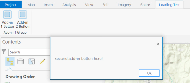

Step 4:  We build and run Pro, and click on the “Loading Test” tab defined by LoadFirstAddin. We see that the button from LoadSecondAddin has updated the “Add-in 1 Group” and has been inserted next to the “Add-in 1 Button”.  With a click, we can see LoadSecondAddin’s button is working:
