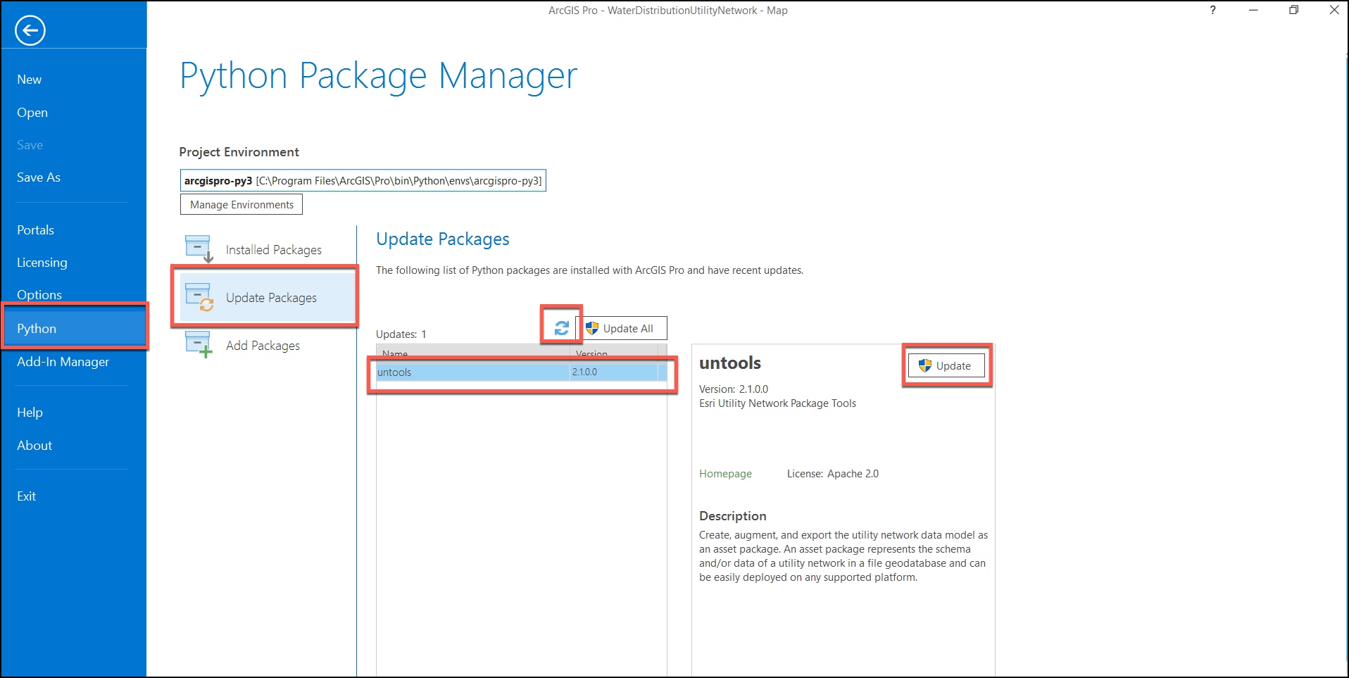

To update the Utility Network Package Tools you will need to use the ArcGIS Pro Python Package Manager.
In ArcGIS Pro, click the Project Tab and then click Python.  In the Python Package Manager, select Update Packages and click the Refresh symbol.  Select untools and click Update.  After the update completes the Utility Network Package Tools version will increment to 2.1.0.1.
