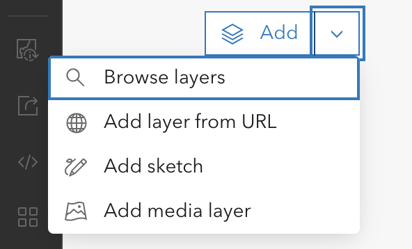

Sketch layers and media layers can also be added in Map Viewer and then used to great effect within map tours.
A screenshot of the add layers drop-down menu in map viewer, showing the options to add sketch and media layers.
Adding sketch and media layers in Map Viewer is pretty straightforward.
Sketch layers allow manual creation of points, lines, polygons, and annotations. For instance, an author could draw a specific route line for a guided tour (generalized progress lines between points are togglable in the options for a guided tour, but those lines don’t follow actual streets or waterways, etc.). Media layers allow map creators to paste an image directly onto a map as its own layer. In terms of a map tour, these layers can be used to add additional iconography or imagery to tour points.

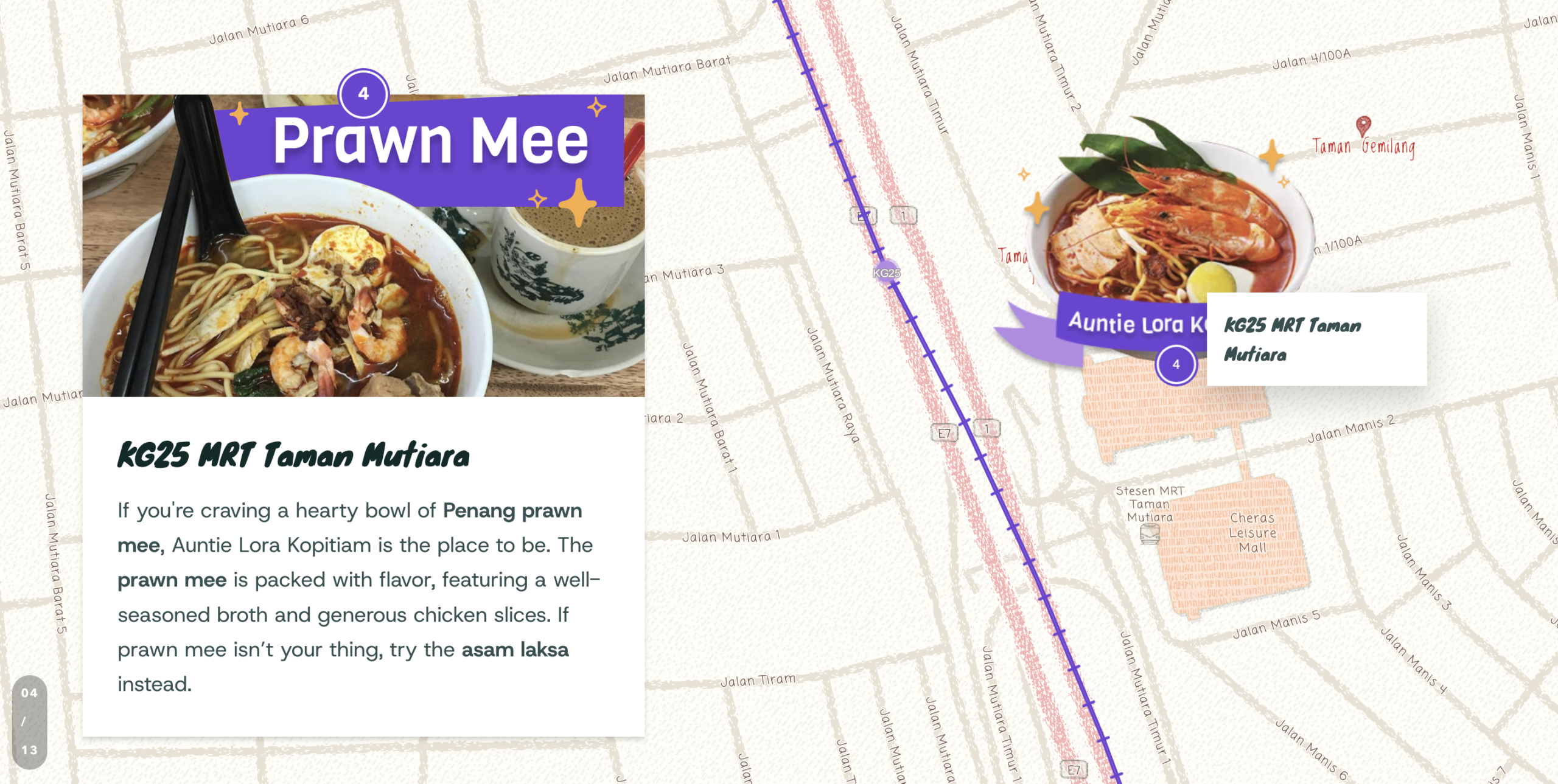

The story May I Walk You Home? uses a basemap with additional layers quite creatively to make a map tour come to life. The tour uses particular restaurant dishes to illustrate the benefits of transit-oriented development. A “train track” illustrates the transit route atop Living Atlas’ playful colored pencil basemap, while media layer images of each mouth-watering menu item appear directly on the map at each stop.
A screenshot from the story "May I walk you home?" showing a map tour stop with a media layer showing a food dish representing a tour point.
The map tour in "May I Walk You Home?" uses additional map layers in creative ways to make a lasting impression on the reader.

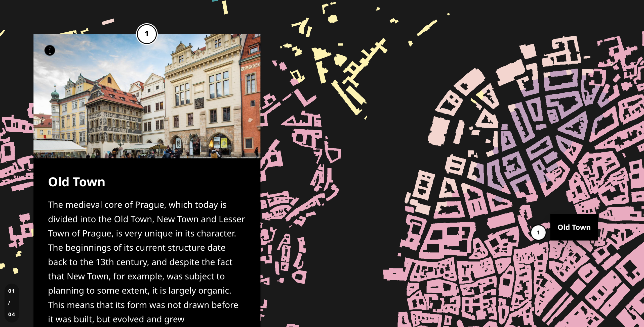

  • Removing irrelevant details — There’s a LOT of information present on pretty much any basemap, and there are plenty of situations where you might not need all of it. The VTSE lets you govern exactly what gets shown on a basemap and at which scales. If things like every street name, point of interest labels, and so on are more distracting than useful alongside the information presented in your tour, you can turn those things off to give your map a cleaner feel.The basemaps used in the map tour in the story The Diverse Prague take this practice to the extreme — everything is hidden except for building outlines, which are color-coded to match different architectural and urban planning styles and vintages, because that’s the only information the tour is looking to relate.
A screenshot of a map tour from the story "The Diverse Prague"
By stripping away all unncessary detail, the map tour in "The Diverse Prague" is able to draw the readers' focus only to the thematic elements that matter most.

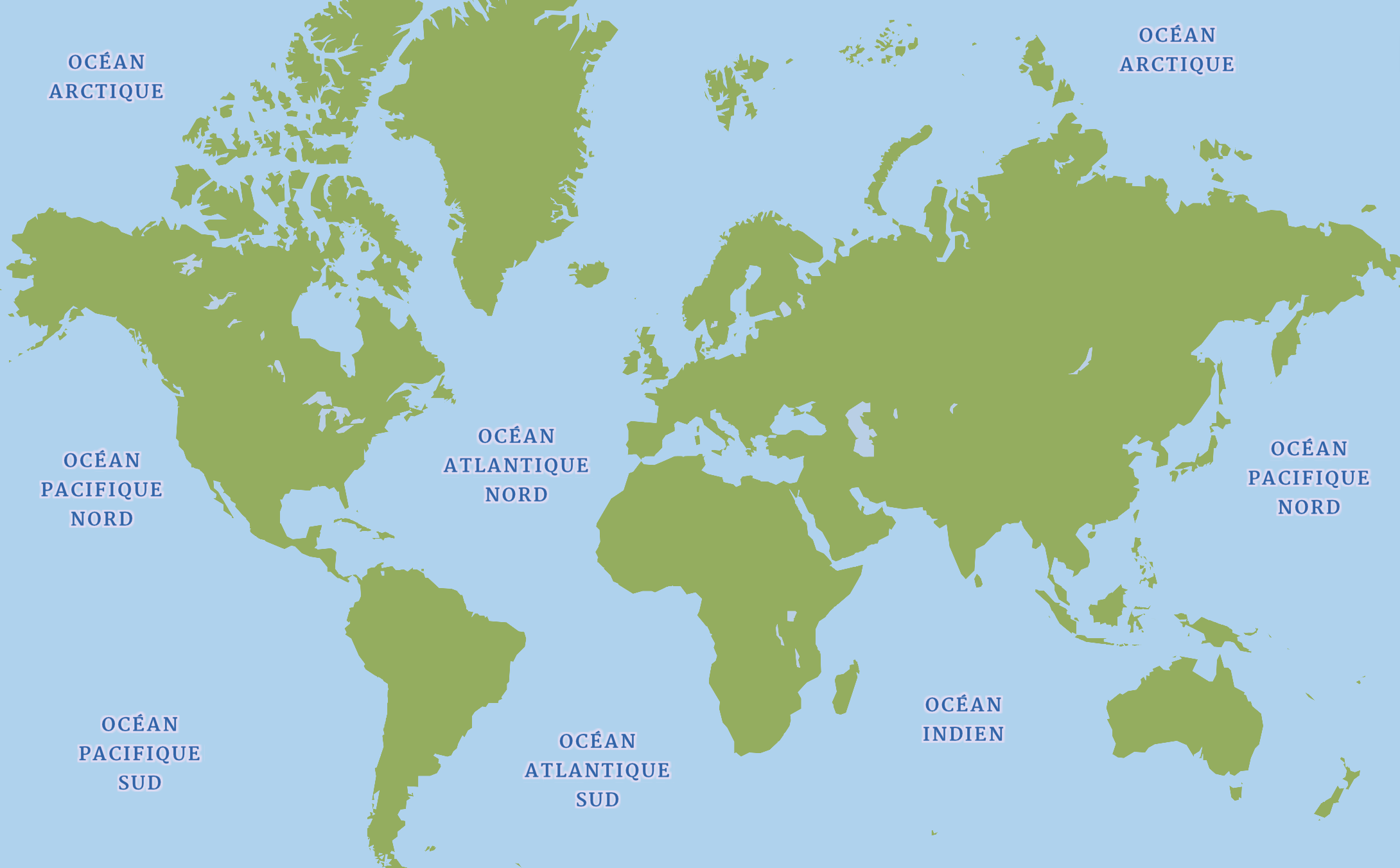

  • Creating translated content for multilingual storytelling — There are many reasons to have versions of a story in multiple languages. The VTSE allows translation of place names and other map labels to make basemaps more accessible to the target audience in a given language. For the French language and Spanish language editions of the story Meet the Beaver, for instance, a modified version of Esri’s children’s basemap was used, with labels appearing in French or Spanish at the smaller scales displayed in the story.
A screenshot of the web map from the French version of the story "Meet the Beaver," with the ocean names appearing in French.
The VTSE can be used to modify particular map labels to appear in a different language.
