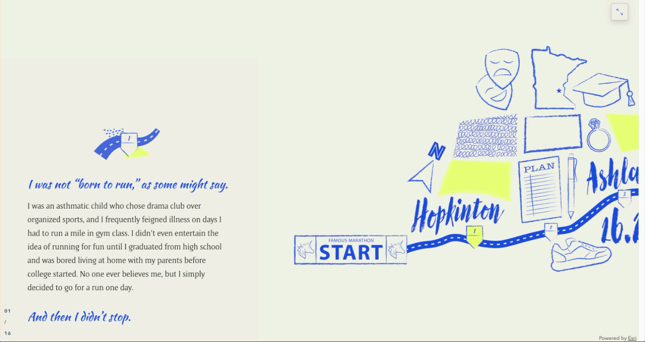

Since I had to avoid any official branding to skirt permissions issues, I decided to draw my journey. I have always been in awe of illustrated digital storytelling efforts, particularly those that use a single image a reader can scroll through. The nature of this famous race, traveling from west to east, was also a perfect use case for a horizontal scrolling experience — moving my reader along 26.2 miles with me. While the result did not utilize traditional data layers, Map Viewer still did the heavy lifting. (And it was still a map!) Here are the steps I took to create my marathon of a story.

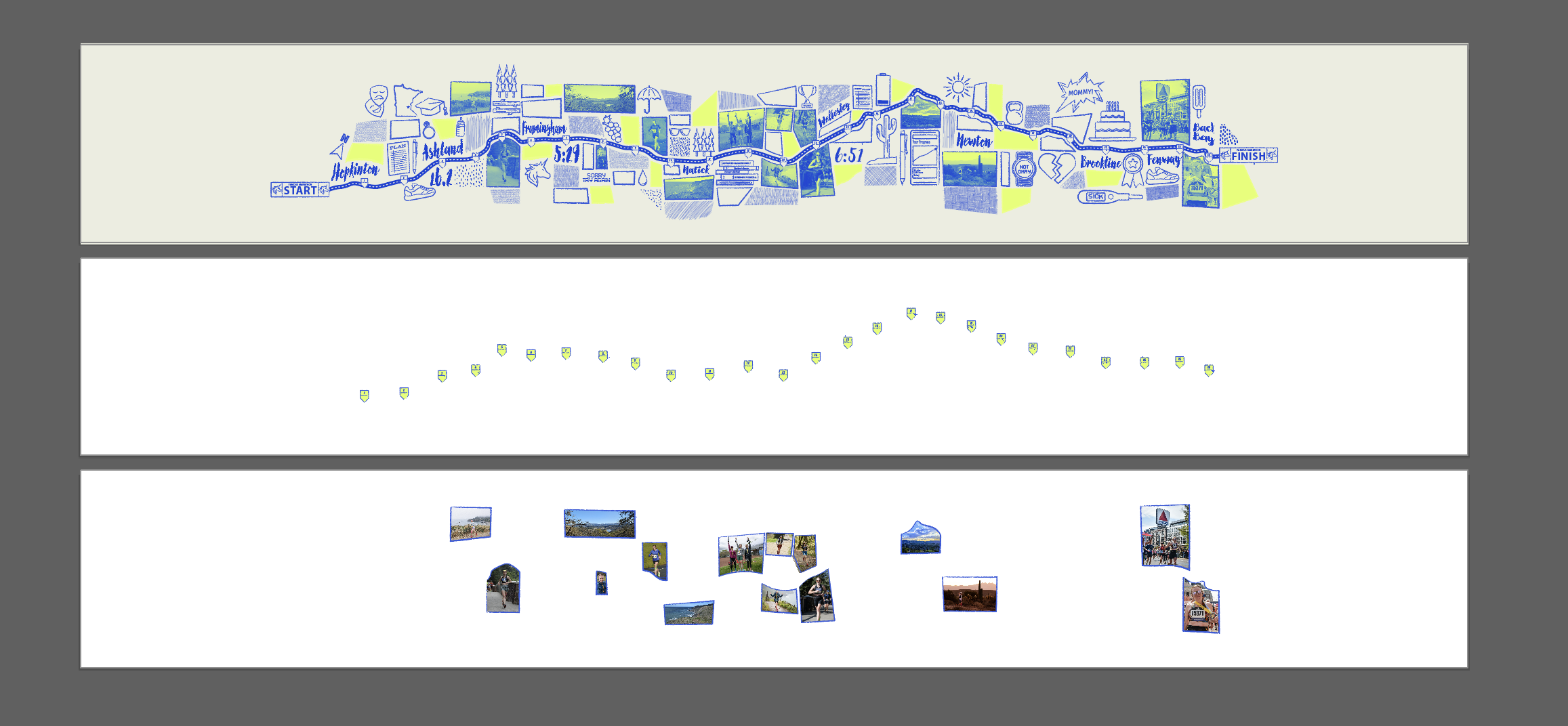

The key to a smooth scrolling experience is one big image. In my illustration software, I set the height of my digital artboard to 1974 pixels, which is larger than a standard full-screen image. I wanted to avoid any part of my design getting cut off, so I added plenty of buffer around the edges. I extended the width of my artboard as needed to fit my entire illustrated race course. My artboard ended up being approximately 13,868 pixels x 1974 pixels, and I made several adjustments after seeing it in the ArcGIS StoryMaps builder.
My story also utilized a few other “tricks,” such as mile markers that turned yellow and images that became full color as the reader scrolled through slides. To prepare these, I created two additional artboards of the same size; the first contained only the mile markers, and the second only the full-color images. It is important that the positions of these elements match their positions in the main image! (Use copy + paste-in-place if your program supports it.) You will want to export your images at high resolution, but be mindful of file size; images larger than 10 MB will not upload to Map Viewer, and large files can impact performance.

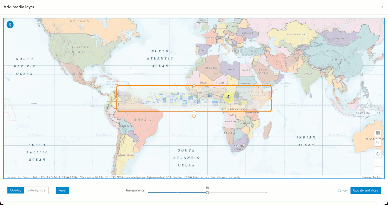

Once the images were exported from my illustration software, it was time to load them as media layers in Map Viewer. Aligning media layers is a relatively quick but critical part of the process, and is made that much easier when your media layers are the same size. My alignment method involved positioning my images relative to elements within a basemap. To do this, I selected the “Charted Territory Map” since it had graticules I could easily reference.
When you load your image as a media layer, you’ll be prompted to position it on the map. Choose an intersection of a latitude and longitude as an “anchor point” and align one corner of your image to this point. Then scale the opposite corner of your image to another readily available line of latitude or longitude while holding ‘shift’ to preserve the aspect-ratio. Repeat this process for all your media layers using the same reference points.
Once everything was aligned, I turned off my base map layer and enabled the background color. The background color in Map Viewer should match the background color of your graphic.

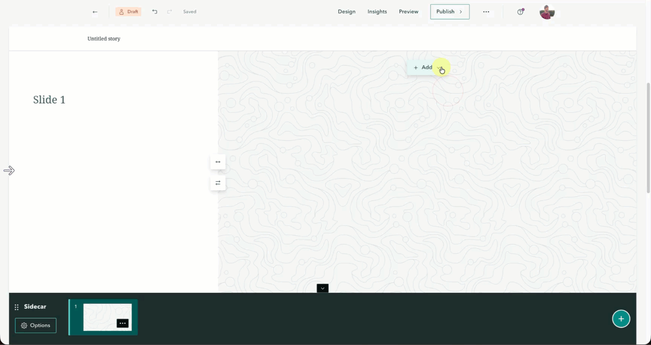

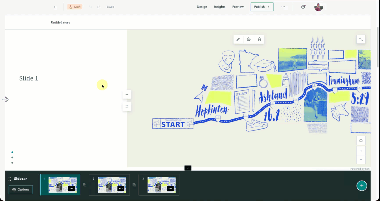

The next task was to set up my story in the builder. A horizontal scrolling experience, much like a regular scrolling experience, is simply a series of sidecar slides. I began with one slide and placed my corresponding text. I then added my “map” and set the extent. (Tip: leave yourself visual notes in your text, so you know which part of the image corresponds to each slide of text.) To create the illusion of moving along the racecourse, I then duplicated this first slide and adjusted the map extent slightly farther “down” the course. The key is to maintain the same vertical extent while shifting only the horizontal extent. One way to accomplish this is to place your mouse in the top-right corner, grab your map, and drag it to the left as far as you desire; your mouse should remain at the top of the frame, keeping the vertical extent the same.
I repeated this process of duplicating the previous slide and shifting the map extent until my narrative was complete.

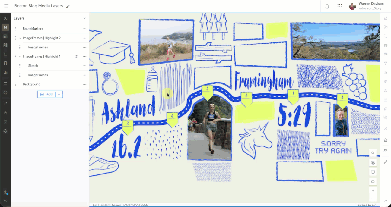

Step 4: Masking in Map Viewer
To elevate the reading experience, my colleague and map wizard, Warren Davison, suggested a few additional “hacks.” The color of the mile markers “light up” (turn yellow) to match the narrative panel, and any corresponding images become full color instead of duotone. This was all done in Map Viewer using a combination of sketch layers and blend modes, and my two additional artboards created in step 1.
To learn how to make clipping masks in Map Viewer, watch this video.
My second sidecar slide, for example, highlighted “miles” 2 and 3 of my narrative, but three other markers and two unrelated images were within the same map extent. I needed these other elements to remain “off,” so they were masked on their media layer to show only the desired markers and images. These masks were named appropriately to make it easier to toggle them on and off within the ArcGIS StoryMaps builder. (I recommend naming by slide number.) This process was repeated for every slide, and, yes, there were a lot of layers! Visual notes in your text will save you a lot of back-and-forth between Map Viewer and StoryMaps.
