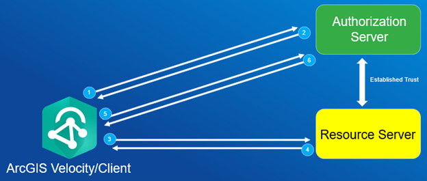

Diagram detailing the relationship of ArcGIS Velocity, Authorization Server, and Resource Server.
1) The client requests an access token from the authorization server. 2) The authorization server sends an access token to the client. 3) The client uses the access token to request data from the resource server. 4) Data is provided to the client by the resource server. 5) The client uses the refresh token to obtain a new access token when the access token expires. 6) A new access token is provided to the client by the authorization server.
We have three primary components when using OAuth – our client, in this example, ArcGIS Velocity, an authorization server, and a resource server. The authorization server is a key component of OAuth and is responsible for authenticating users and issuing access tokens with proper access policies. It can do this because of the trust it has established with the resource server. The resource server will hold our secured resource, such as an API providing vehicle data access.
The first step of this workflow is for ArcGIS Velocity to request an access token from the authorization server. If this request is made correctly with the parameters the authorization server expects, the authorization server will return a response as shown in the image below. The response includes an access token, a refresh token, the token’s type, and an expiration value that tells us when the access token will expire. Note that refresh tokens are a central part of OAuth but are not required.

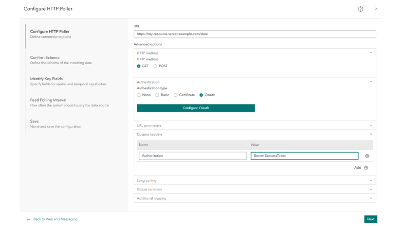

In the explanation below, I’ve opted to utilize the HTTP Poller feed type, as this will allow me to demonstrate the optional refresh token configuration step. I start the configuration process by choosing Create Feed > Web and Messaging > HTTP > HTTP Poller.
On the “Configure HTTP Poller” page, I will enter the HTTP endpoint used to access data on my resource server for the URL parameter. I’ve chosen GET as the HTTP Method, as my resource server expects a GET request from clients to pull data. For the custom headers parameter, I’ve set a parameter “Authorization”: “Bearer $accessToken,” as my resource server is configured to only return data if the incoming request includes an “Authorization” header with a valid bearer token as a value. Note that $accessToken is a global variable – ArcGIS Velocity will be able to populate this value and update it as needed based on the configuration we will complete below. Following these changes, I will select “OAuth” under “Authentication” and then select “Configure OAuth”. Your resource server may require URL parameters or additional headers, which should be added before preceding.

In the Configure HTTP Poller window, a URL endpoint is specified for the resource server, an HTTP Method of GET is chosen, Authentication type is set to OAuth, and a header “Authorization”:”Bearer $accessToken” is set. Optionally, URL parameters, additional headers, long polling, global variables, and additional logging can be configured.

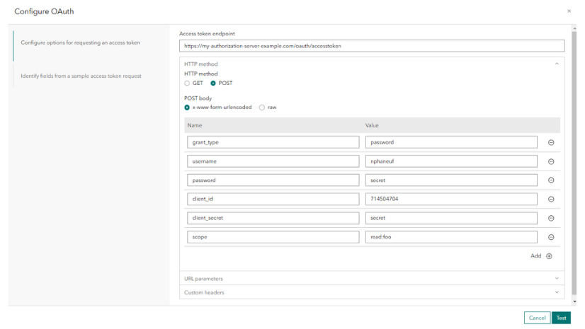

Next, I am prompted to configure options for requesting an access token. For the access token endpoint parameter, I will enter the HTTP endpoint to request an access token from my authorization server. Your HTTP Method, POST body, URL parameters, and custom headers will depend on the values expected by your access token endpoint. In this case, my authorization server expects a POST request with the expected values in the POST body for “grant_type”, “username”, “password”, “client_id”, “client_secret”, and “scope.”
image of the "Configure OAuth" modal in ArcGIS Velocity.
On the Configure options for requesting an access token window, the URL for the access token endpoint on the authorization server is set as the access token endpoint, an HTTP Method of POST is selected, and a POST body is configured based on the format expected by the authorization server. Optionally, URL parameters and custom headers can be configured.

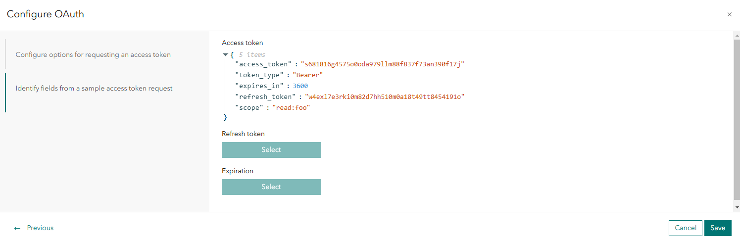

When I click “Test”, ArcGIS Velocity will attempt to obtain an access token from the endpoint specified. If this test fails, verifying that you’ve configured the request successfully by attempting the same request outside of ArcGIS Velocity (ex: using Postman or PowerShell) can be helpful. You can also use the Developer Tools in your browser to see if your resource server returned a response or error to this test request.
If this test is successful, ArcGIS Velocity will prompt you to identify which key/value pair will be used to obtain your access token. In the case below, I will click “access_token”. As a note, ArcGIS Velocity expects a key/value pair and does not currently support other formats.

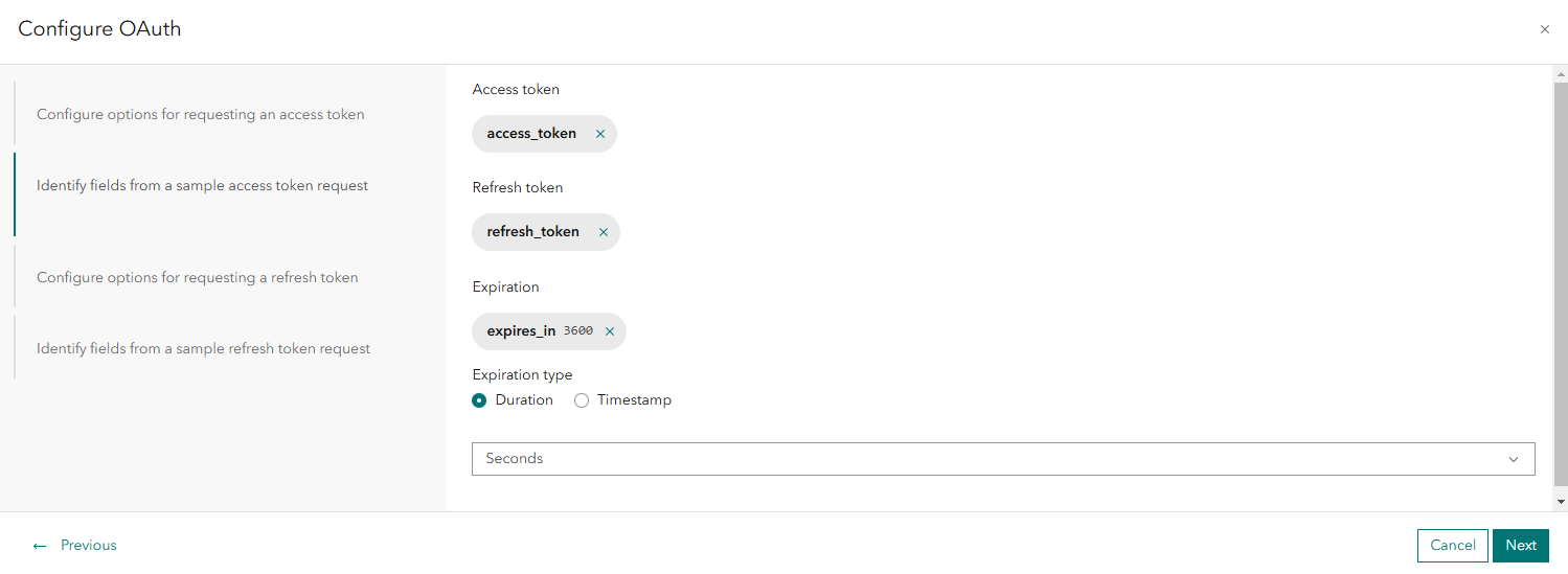

On the Identify fields from a sample access token request window, the access token key/value is selected. Optionally, users can configure a refresh token and expiration.
ArcGIS Velocity also provides the option to configure the refresh token and access token expiration from this page, both of which are optional. If a refresh token is specified without an expiration, ArcGIS Velocity will attempt a refresh token request if a data request fails twice in a row. In my case, I’ve chosen “refresh_token” as my refresh token and “expires_in” as my expiration. My access tokens expire after 3600 seconds, so I’ve selected “duration” and “seconds” for my expiration type. With these options selected, ArcGIS Velocity will automatically use the refresh token endpoint to obtain a new access token from the authorization server when the access token expires.

When an expiration is set in the Identify fields from a sample access token request window, users can choose a Duration or Timestamp and choose the units from the dropdown to identify the length of time that an access token can be used before it needs to be refreshed.

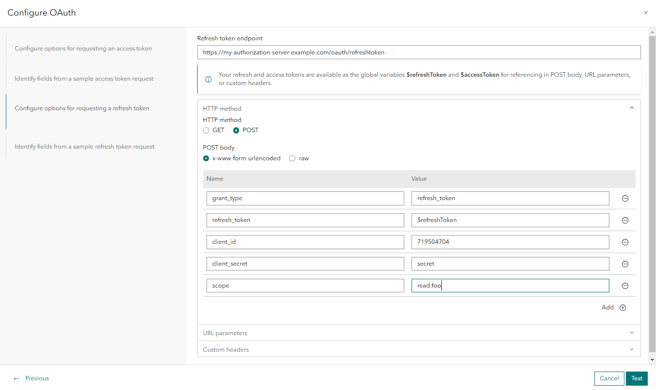

If a refresh token was configured in the previous step, we will need to configure a sample request to the refresh token endpoint, which will allow ArcGIS Velocity to obtain a new access token and refresh token. Similarly to the access token endpoint, I will enter the HTTP endpoint to request a refresh token from my authorization server for the refresh token endpoint parameter. Your Method, POST body, URL parameters, and Custom headers will depend on the values expected by your refresh token endpoint. In my case, my authorization server expects a POST request with the expected values in the POST body for “grant_type”, “refresh_token”, “client_id”, “client_secret”, and “scope.”
My refresh token endpoint requires that I provide my refresh token value in the POST body to obtain a new access token. In the refresh token request, ArcGIS Velocity supports both the $refreshToken and $accessToken global variables in the POST body, URL parameters, and custom headers, as the expected format and location of these global variables will depend on the authorization server configuration.

On the Configure options for requesting a refresh token window, the HTTP endpoint for requesting a refresh token from the authorization server is set as the refresh token endpoint, an HTTP Method of POST is selected, and a POST body is configured based on the configuration expected by the authorization server. Optionally, URL parameters and custom headers can be configured.

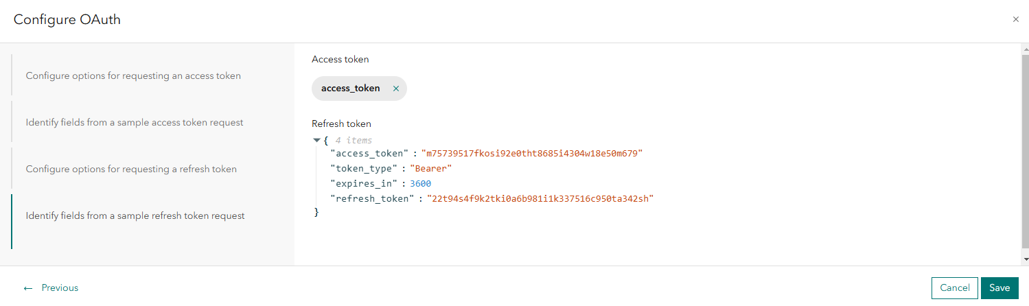

When I click “Test”, ArcGIS Velocity will attempt to obtain a refresh token from the endpoint specified. Similarly to the access token sample request, Postman, PowerShell, and your browser’s Developer tools can help troubleshoot unsuccessful connections. If this test is successful, ArcGIS Velocity will prompt you to identify which key/value pair will be used to obtain your access token and refresh token, similar to the workflow we followed above for the access token configuration. In my case, I’ve chosen “access_token” and “refresh_token.”
In the Identify fields from a sample refresh token request window, the access token and refresh token key/value pairs are identified.

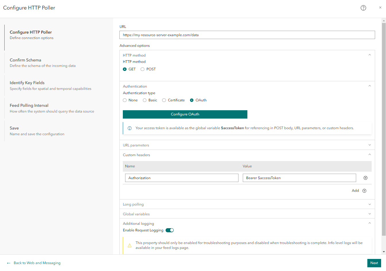

As a helpful note, the HTTP Poller feed and HTTP output include the option to “Enable Request Logging”. If a feed or output that uses OAuth is not working as expected, this property can be enabled to assist with troubleshooting. When this parameter is enabled, all access token, refresh token, and data requests will be logged in ArcGIS Velocity’s logs. If data is not being ingested or written as expected, view the responses from the access token, refresh token, and data requests to help identify if changes need to be made to your OAuth workflow. This property should only be enabled for troubleshooting purposes and disabled when troubleshooting is complete.

Once OAuth is configured, the Configure HTTP Poller window will open. This window provides an optional "Enable Request Logging" parameter, which will log all access token, refresh token, and data requests to assist with troubleshooting.
