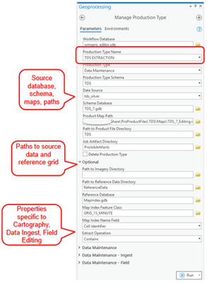

This new framework requires different extended property tables in the Workflow Database than previously used in ArcMap. There is no automated migration of the previous tables to the new format, meaning that your existing Extraction, Cartography, and Field Editing operations (for example) must be re-created in ArcGIS Pro. These are called Production Types in the new workflow framework, and it is a straightforward process using a geoprocessing tool to create them and set key paths and properties. See the following image:

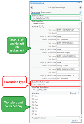

The new workflow framework has been made more flexible with the introduction of Task Groups, which dictate, for a given production type, specifically which child jobs need to be included, in what order, their expected level of effort, and which groups or users should be assigned. Like Production Types, Task Groups can also be created and modified using a geoprocessing tool, and you will need to create them for your production environment before using the workflows. See the following image that shows the process for creating a Task Group that uses the TDS EXTRACTION Production Type from the previous image:
In the example, we are defining that for TDS Extraction, tasks (child jobs) will be created to create the replica, maintain (edit), QC, and finally to publish the data updates. Sample task groups such as this are included in ArcGIS Production Mapping to use as a starting point. You can add, remove, reorder, and modify the tasks using the tool above as you need. For example, if a specific type of work does not require a formal QC process, the DATA-QUALITY CONTROL task can be removed. Or, if all QC should flow through a specific group, the Default Assignment for the QC task can be set to that group. Additionally, expected levels of effort (LOE) can be defined along with standard working days and hours. This enables the workflow system to automatically generate an overall expected level of effort for each Task Group (parent job) by aggregating those of each child task, and tracking how delays in any child task will affect start dates of tasks downstream and ultimately the expected due date of the parent job.
To summarize, Production Types (similar to the Extraction/Cartography/Field Editing operations in ArcMap) and Task Groups are how you configure the system to your production tasks and files. Production Types dictate the key paths and files for the workflows to use, and Task Groups dictate which child workflows to actually use for a given Production Type. You must define these during the initial configuration of the environment using the geoprocessing tools shown above.
