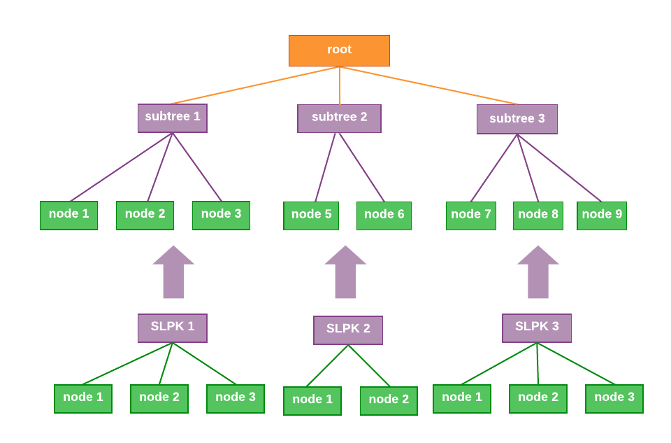

The goal was to create a single URL for the mesh layer. Because data is not processed all at once it was important to be able to append new parts of the mesh. This requirement was accomplished using a script to append data.
Details
The i3s format requires an indexed structure where all nodes ordered in a bounding volume hierarchy. To append data, you can organize subtrees underneath the root node and re-index. Besides recreating the index, you would also have to consider:
  • A maximum of 255 subtree of nodes can be created under a parent node
  • When working with 3D objects featureIDs must be unique for the entire layer and not only for the subtree
i3s structure
Workflow to append subtrees to one i3s structure.
IT.NRW uses a python script to update the hosted i3s service every time a new area of the mesh has been processed. The entire area is split into fixed sub-areas that will be surveyed following a predefined schedule.
The python script can be adapted to work for different i3s profiles like 3D objects, mesh, points, or formats like SLPK or I3SREST.
