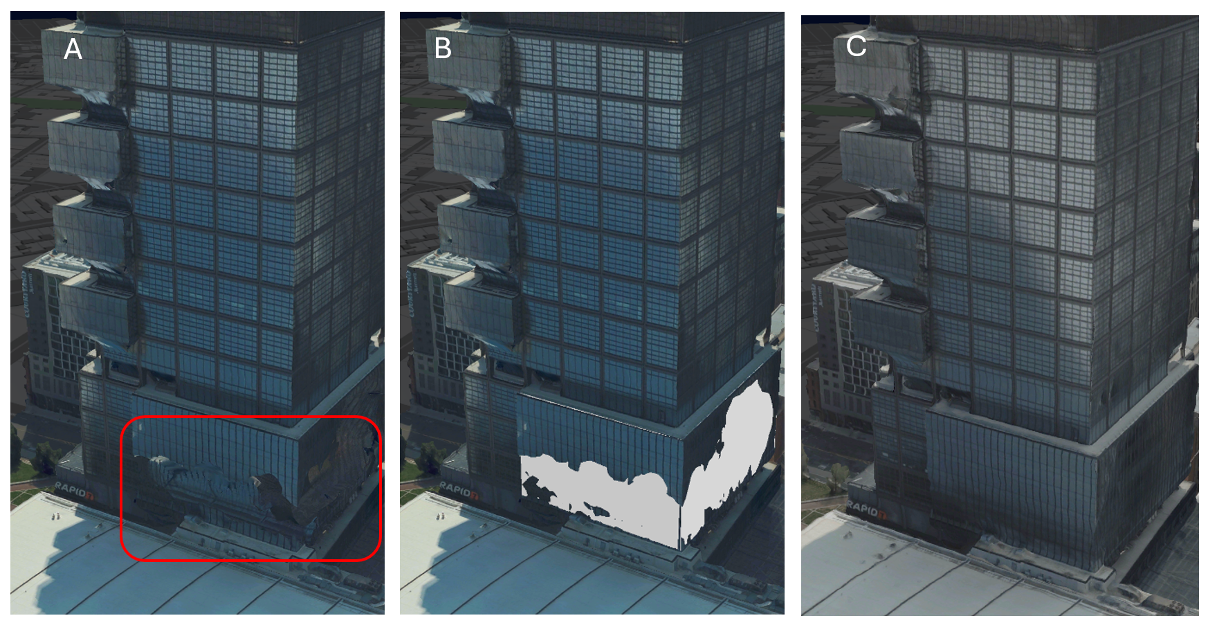

Mesh editing in Reality Studio: (A) a mesh with holes in the glass facade (highlighted by red rectangle), (B) correction geometries drawn onto the mesh, (C) the corrected mesh - Data courtesy: Bluesky
The images above illustrate the workflow of in-app editing: The left image depicts a mesh with holes in the glass facade of a building, which is challenging to reconstruct automatically due to its reflective surface. In the central image, a correction geometry is drawn (white), which follows the actual building shape. After reprocessing, these corrections are taken into account and the improved mesh is visible, as shown in the right image.

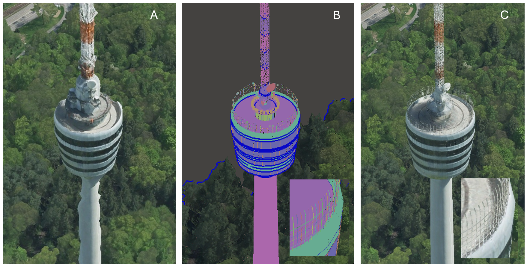

Mesh editing with external applications: (A) mesh of a landmark with artifacts, (B) edits in an external app, (C) the corrected mesh after integration of the edits - Data courtesy: Geofly
The example above shows an architectural landmark for which there may be a special interest in reconstructing it and its intricate details with the highest possible quality (shown in A). A quality control polygon is drawn to mark this region of the mesh. It is specified when exporting the edit packages to include only the minimum context around the marked defects, enabling effective editing operations. The OBJ file of the edit package can then be opened in an external mesh editing app for manual edits (shown in B). After saving the changes to the same OBJ, the edit package is passed to the reconstruction for integration of the edits into the mesh. The final mesh (shown in C) shows the corrected geometry.
Tip: The quality control area does not need to be precise, but can approximately outline the affected area

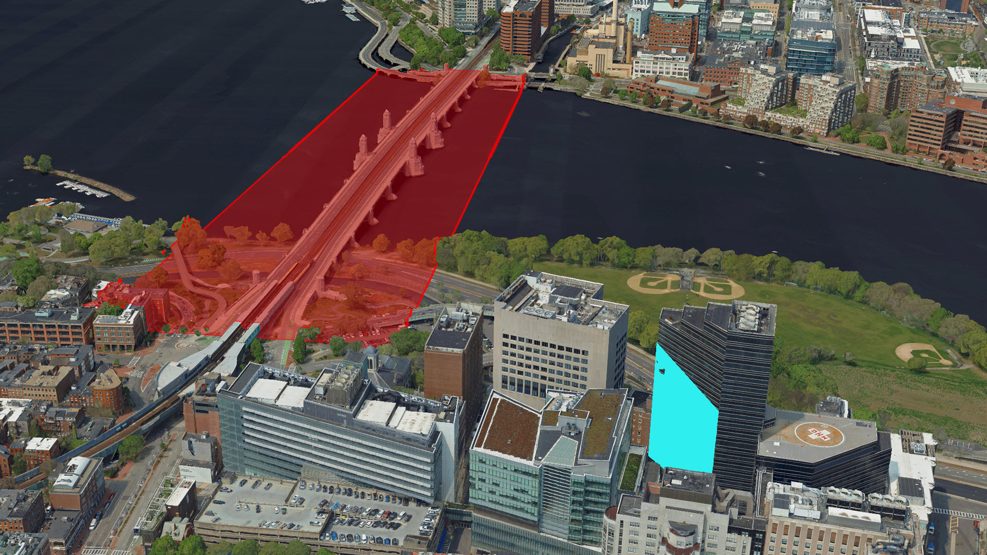

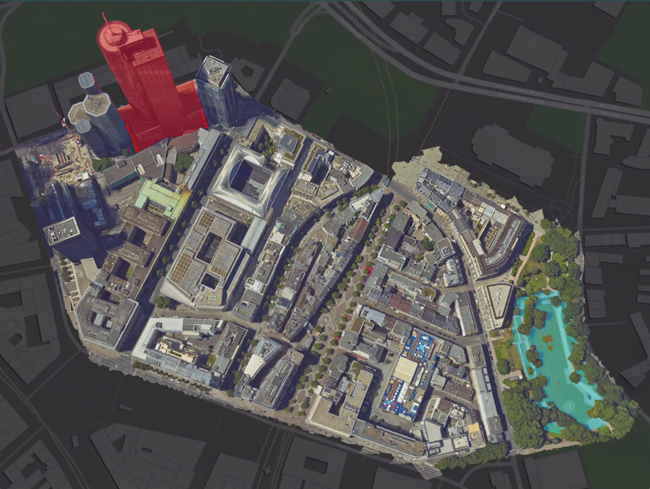

Combined editing: A quality control area (red) is applied in the top left corner, while a water body geometry (light blue) is used in the bottom right corner. - Data courtesy: Aerowest
The image above illustrates the combination of editing tools: On the left-hand side, the quality control area for external editing is highlighted in red. On the right-hand side, a water body geometry is shown above the lake in blue.
