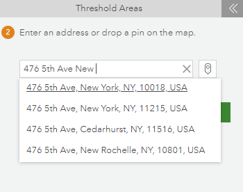

Threshold areas use a single point, point layers, or multiple site locations. I entered the Schwarzman Building’s address into the search box.
Searching for the Schwarzman Building

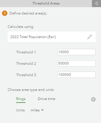

Now, it’s time to set the threshold areas. I am using threshold areas of 10,000, 50,000, and 100,000 people. You can set your threshold areas to calculate using data from 2022 Total Population (Esri), 2022 Total Households (Esri), or browse variables for other data options. For the first example, I selected the variable 2022 Total Population (Esri). The Esri 2022 data includes an array of demographic and socioeconomic data.
threshold area selections

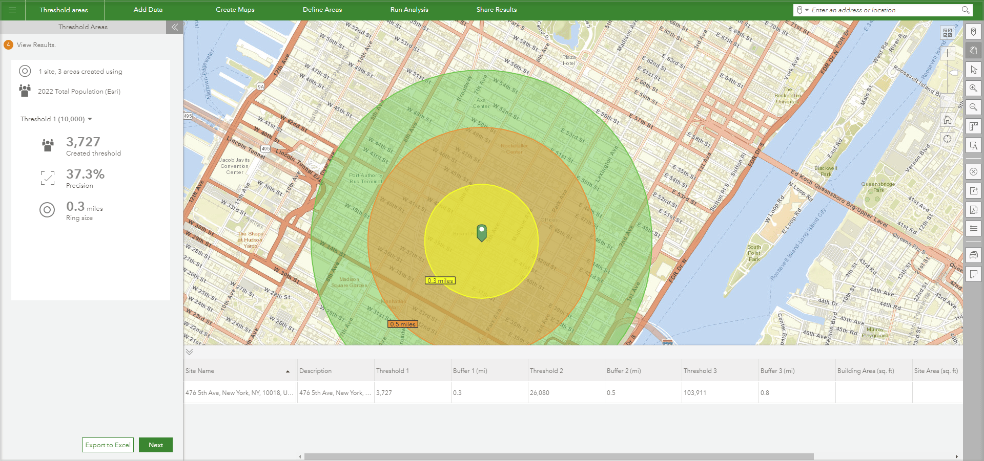

A new layer is created with my sites and threshold area rings.
Threshold areas example
The Threshold Areas panel includes facts about the thresholds for your site. It shows you the number of people in each threshold area, how precise the ring is, and the ring size. The first threshold area serves 3,727 patrons within 0.3 miles of the library. The next threshold area serves 26,080 patrons within 0.5 miles of the library. The third, and largest, threshold area serves 103,911 patrons within 0.8 miles of the library. Since the threshold areas in this example are set by the population and not geographic distance, the ring size varies for each threshold area.

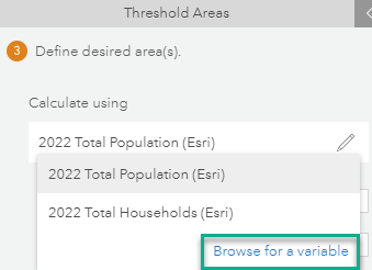

To select a new variable, I clicked Browse for a new variable.
Browse for a variable
The data browser opens, which includes a portfolio of business and demographic data that is curated and periodically updated. I selected the data collection Education, then School Enrollment to find the variable 2021 Pop 3+ Enrolled in School (ACS 5-Yr).
