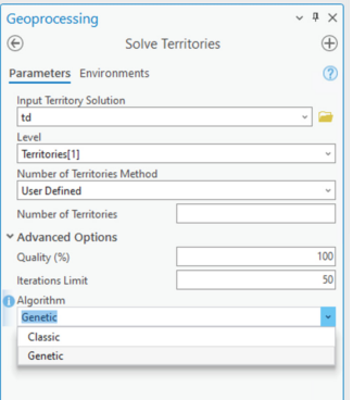

With the release of ArcGIS Business Analyst Pro 3.0, there is a new option for solving a territory solution. The option is based on a genetic algorithm that uses heuristics to solve your territories. As shown in the figure below, the new algorithm option is called Genetic. The other option, Classic, is the original algorithm that has been used in Territory Design since it was first introduced in ArcGIS Pro.
Territory Design solve tool methods
