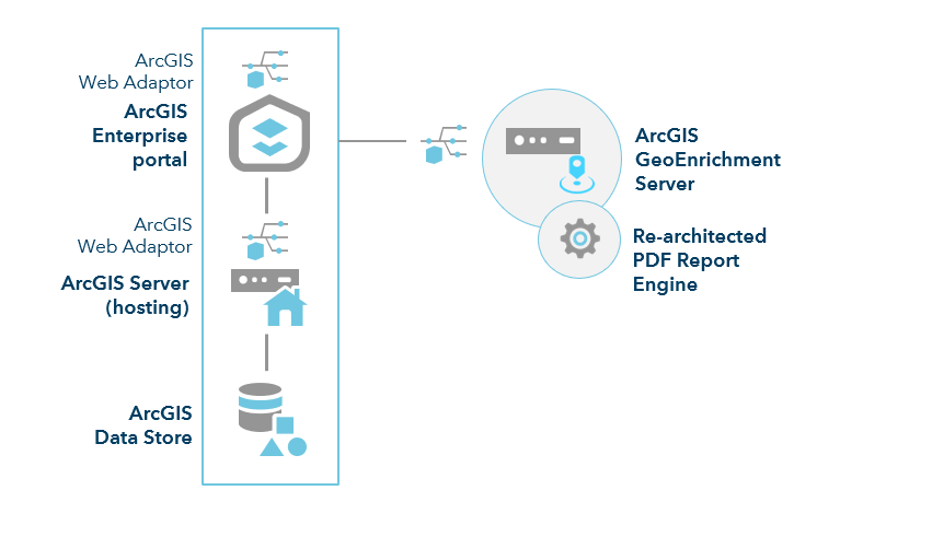

The work was focused primarily on rearchitecting the way demographic PDF reports are created in BA Enterprise. In a nutshell, the engine which generates the PDFs was originally written in .NET and needed to run on Windows. That engine has been replaced by a new JavaScript component that can run on any platform.

GeoEnrichment Server is an extension of ArcGIS Server and requires a federated server separate from the hosting server. After running the software setup, there are some post installation steps to follow for creating services and loading data to the database. These steps can be done in a GUI mode using a wizard driven experience or in the console.

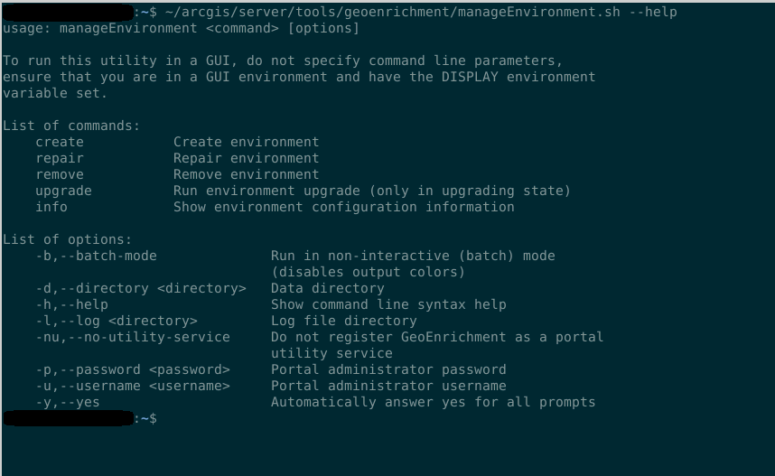

Creating the server environment can be accomplished in console mode with the Manage Environment tool. This tool publishes the GeoEnrichment service and creates an empty database which we’ll load data to in the next step. Here’s a look at the parameters of this tool. For example usage, please refer to the setup guide.

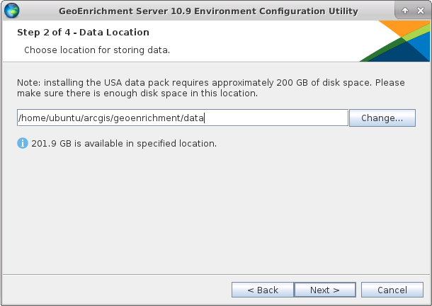

Creating the server environment can also be accomplished in a GUI mode with a provided wizard.  The wizard walks through the steps of providing a username and password and data installation directory instead of entering them in the console.

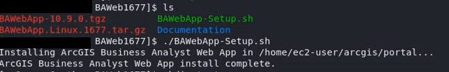

The BA web app can be installed on the machine with the enterprise portal. The setup is very simple and is run with the BAWebApp-Setup.sh script. There are no additional parameters required for the installation, for example:

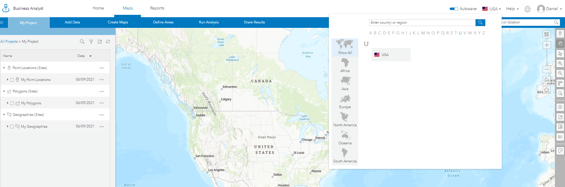

And we’re done! Let’s sign into the BA web app and make sure that the US data is available for our analysis and workflows.
