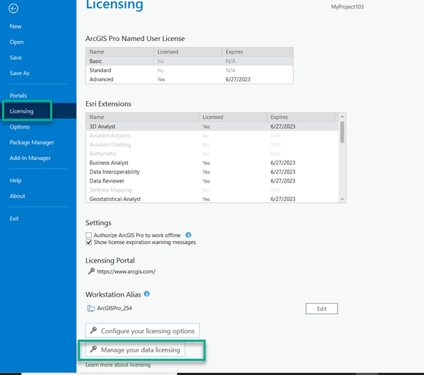

3. On the ArcGIS Pro start page, click Settings in the upper left corner of the application window. Alternatively, if you have a project open, click the Project tab on the ribbon.
The Settings page opens.
4. In the menu, on the left side of the application, click Licensing.
5. Click Manage your data licensing.
Manage Licensing from Settings

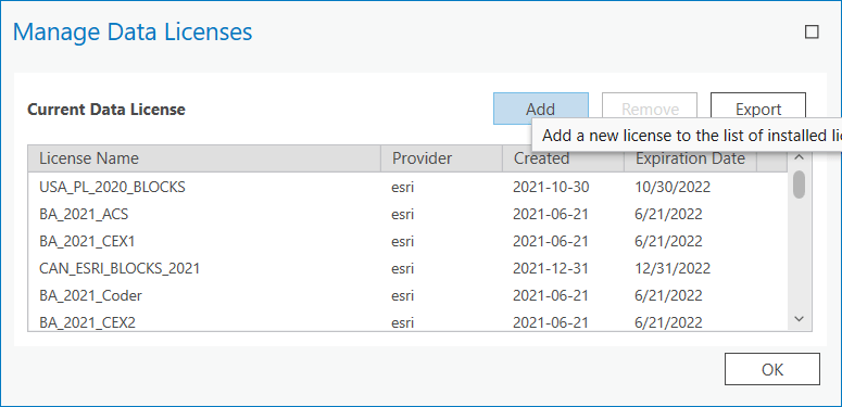

The Manage Data Licenses box opens.
6. Click Add and browse to  the .sdlic file.
Add new data license.
7. Select the .sdlic file and click Open.
In the Manage Data Licenses window, a list of the Business Analyst datasets will be shown.
8. Click OK and exit the Licensing window.
This concludes the installation process and your Business Analyst dataset is now ready for use. Additional details can be found in Licensing documentation.

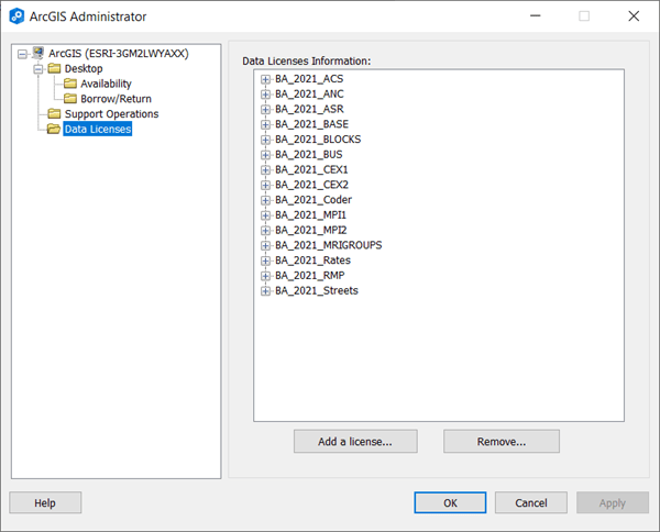

I have ArcMap only, or have both ArcMap and ArcGIS Pro installed.
If you have Business Analyst for ArcMap installed, the process is slightly different, as ArcMap contains the ArcGIS Administrator module.
  1. Initiate installation by double-clicking the updated .sdlic file on your local machine.A window opens that asks ‘Do you want to allow this app to make changes to your device?’
  2. Click Yes. The ArcGIS Administrator window opens, displaying your updated data license components with new expiration dates.
ArcGIS Administrator.
This concludes the installation process and your installed Business Analyst dataset is now enabled for use. Detailed instructions can be found in Authorizing your software and data.
