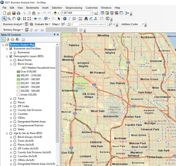

What do Business Analyst MXDs contain?
Business Analyst MXDs contain BDS files and Business Locations points. The BDS files contain the full set of demographic variables from the Business Analyst dataset as attributes, and geometries for all administrative boundaries, in the map.
You can access all data in the Business Analyst MXDs in ArcGIS Pro without loading it to your map. This approach improves performance and eliminates redundant geometries from your contents pane. If you need to load a subset of Business Analyst data to your ArcGIS Pro map to complete analysis, you can do so using geoprocessing tools in the application. However, loading all Business Analyst data to your map, like in the MXDs, is likely not necessary.

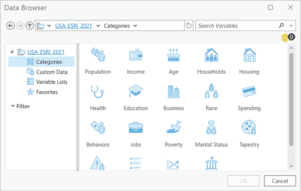

How do I access BDS variables in ArcGIS Pro?
In ArcGIS Pro, the data browser contains Business Analyst summary data, including variables stored in BDS format.
Summary data consists of variables summarized for polygon geographies, such as Block Groups, ZIP Codes, or Provinces:
  • Standard Business Analyst summary data resides in data collections that you can find through the Categories node in the data browser.
  • Custom local summary data created in ArcMap remains in BDS format and is accessible from the default location of C:\MyOutputData, through the Custom Data node in the data browser.
  • Custom summary data created in ArcGIS Pro are stored in Statistical Data Collections. These variables are also accessible through the Custom Data node in the data browser.
Data Browser in ArcGIS Pro
To access the data browser in Business Analyst tools, click the Add Variable button. You do not need to format or export your BDS data to access it through the data browser.
You can use your custom BDS data in the following tools: Color Coded Layer, Enrich Layer, Suitability Analysis, Measure Cannibalization, and Generate Grids and Hexagons. Additionally, you can run custom report templates created in ArcMap from Business Analyst data through the Summary Reports tool.

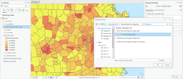

Add a thematic map
Thematically shaded maps, or choropleths, are a defining characteristic of Business Analyst MXDs. Let’s walk through creating one in ArcGIS Pro. Before selecting a variable to be thematically mapped, you must set the Business Analyst Data Source, which defines the Business Analyst dataset used for analysis. In this case, we will select the locally installed USA_Esri_2021 dataset.
  1. Click the Analysis tab and the click the Business Analysis button in the ribbon. The Business Analysis menu expands.
  2. At the bottom of the dialog, click change data source. Browse to and select USA_Esri_2021 as the Business Analyst data source.
  3. With the Analysis tab still active, click the Tools button in the Geoprocessing section of the ribbon. The geoprocessing pane opens.
  4. In the Find Tools text box at the top of the pane, type Color Coded Layer. The Color Coded Layer tool opens.
  5. Click the plus button next to the Classification Variable parameter to open the data browser. By default, Categories in the left-hand pane of the data browser is selected. The right pane contains categorized data collections that represent the full breadth of the Business Analyst dataset.
  6. You could click Custom Data in the left pane to display available custom BDS variables, such as your sales data and Statistical Data Collections for mapping. For now, we will select a standard Business Analyst variable for display. Click the Spending category, and then click the Common Spending Variables folder.
  7. Select the variable 2021 Retail Goods and keep the # selection to display the total amount spent on retail goods. Click OK and then click Run at the bottom of the tool.
Color Coded Layer Tool
The variable is thematically shaded in a group layer containing five levels of geography, ranging from block groups to states. Display properties control which level of geography is drawn as you zoom in and out. To display a different variable thematically, simply re-run the tool.
