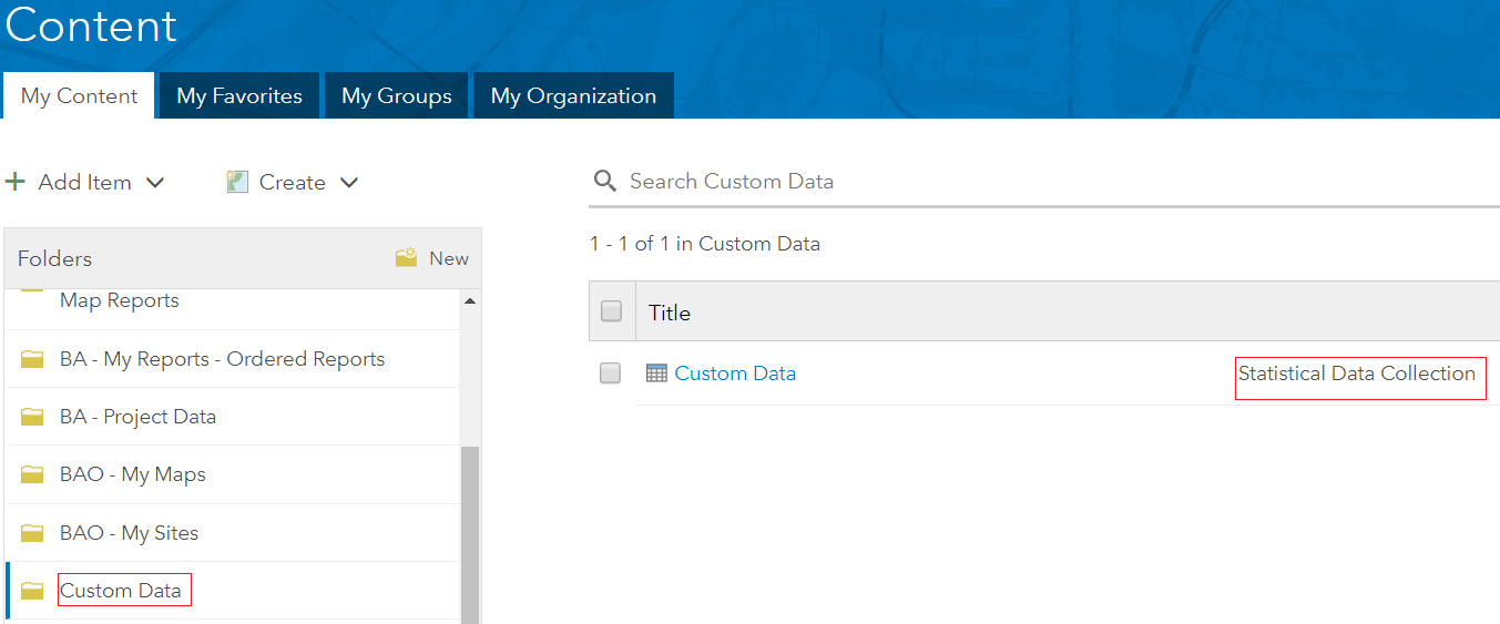

The file resides in your portal content in a folder called Custom Data, if this folder does not exist it will be created automatically when you build your first data collection:
